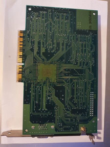

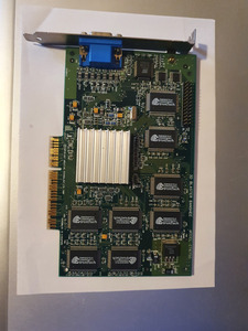

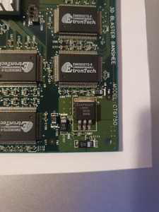

Hi.
So it was me who got the card and I did some inspecting and testing.
I didnt see anything that could indicate what might be wrong but:
1, I found 1 pin on a memory chip that was loose, now fixed.
2, I got the card booting and it works both in windows and in 3d. Tested with Unreal.
3, The card runs extremly hot! Even in idle, is this normal for the banshee?
4, Sometimes the card refuses to boot. Reseating the card helps some times but what works almost all the time is tilting it slightly backwards.
I suspect that there is another cold solder joint somewhere.
5, The area around the voltage regulator gets really hot and, I guess its the factory flux around it's pins, has gotten really black and crusty.
So, can a pin on a memory chip prevent the card from booting entierly?
When the card boots it works great so even if it's a cold solderjoint or there like why does it work when it boots?
My suspicion is in the area around the voltage regulator as it gets really hot and if I tilt the card from this corner it boots.
I have gone over the memory chips and all legs seems like they are attached.
I'll attach some pictures of the card.
Reply 27 of 47, by Doornkaat
Nice update!👍
Some Banshees get very hot and some discoloration on the back isn't unusual, especially with a simple heatsink like that.
Still you could check wether that LDO works right by checking what voltage it's putting out. If it malfunctions the chip may be overvolted.

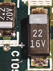

Also it's probably just from lighting but is it possible C107 has a cracked solder joint?
Reply 28 of 47, by filurkatten
I'll check the regulator later today or this weekend.
Need to put together a test computer to be able to reach it and probe it properly.
C107 maybe looks a bit off but I think it's fine. Multimeter gives continuity but I'll reflow it just in case.
Here are pictures of it
