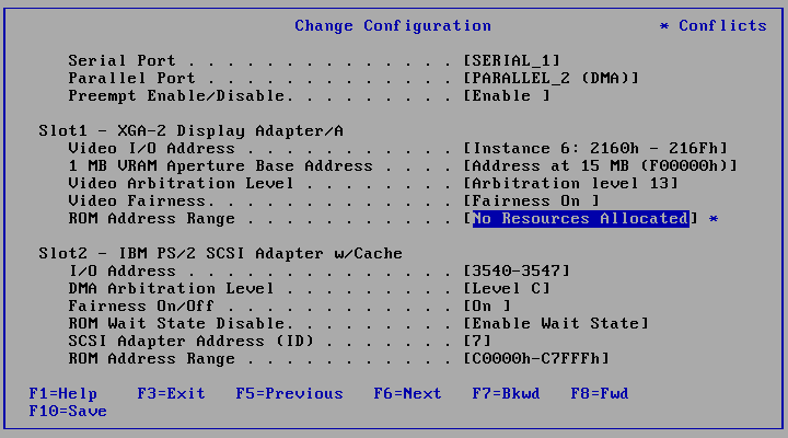

Hi, I am fighting few problems with the very new XGA emulation in 86box:
1) https://github.com/86Box/86Box/issues/2983
2) https://github.com/86Box/86Box/issues/2968#is … ment-1353478837
and 2) even the developer of the emulation has no any idea at the moment.
So, I want to investigate further problem 2).
That's why I wonder if someone here owning real IBM PS2 and XGA card on MCA bus running DOS (i.e. having DOS installation or has no problem making one on that machine) is willing to help. More specifically - I plan to write a small tool that can dump some XGA register values and that way we compare the difference with 86box emu. Thanks and let me know!

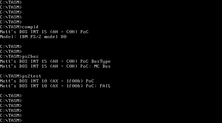

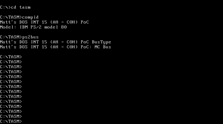

I have a model 80 in storage with an XGA2 adapter, I might be able to help out if you don't require anything too complicated from me 😀
nope, it's very easy, it will be just boot to dos, copy and run few exe files that I provided to you and tell the output - see the attached screenshot for example (I have more tools that you will need to run on the real hardware, but it's just that - run few exe, collect the output, nothing complicated).

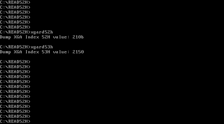

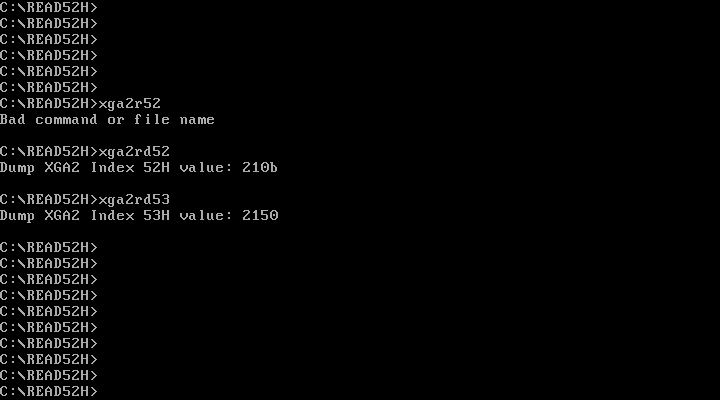

Reply 5 of 35, by mattw
@MMaximus
and just to add if you take your PS2 out of storage first you can do is download this:
https://web.archive.org/web/20140911121135if_ … es/xga2util.zip
and run:
xga2 -v >> xga.log
and upload the "xga.log" here and we proceed from there. Right now, I am counting on you, but everyone else with suitable hardware is welcomed to do the same and then follow with me with few more tests. Totally it will take you minutes.

OK, here are the next 4 test tool and they are the last ones I have for the time being, i.e. after we collect the output from them I will not bother you with more tests (at least for some time until I am analyzing the results and trying to make more sense what is going on):
https://www.mediafire.com/file/aztaad023lw8wa … atests.zip/file
and here is their overview:
* "XGARD53H.EXE" - very important, it reads XGA Index 53H, which as far as I can tell is totally undocumented, hence why is so important we collect values from several different systems
* "XGARD52H.EXE" - important, t reads XGA Index 52H, it's documented, but I am not sure for few bits and that will help to confirm them
* "PS2BUS.EXE" - optional, run it if you're not lazy doing, it just checks if it can detect MCA bus, in which case the output is "MC Bus", otherwise the output is "PC bus" and the last one is very wrong if it happen in PS/2 system with MCA
* "COMPID.EXE" - very optional, it tries to detect the PS/2 model
Here are screenshots from my run of those tools in 86box:

[EDIT] OK, here is the fix for XGA-2:
https://download1073.mediafire.com/pwm3wsm2cv … 70/xga2rd5x.zip
I called the new tools "xga2rd52" and xga2rd53" - to avoid confusion and mistakes - also the output will say "XGA2" - as the attached screenshot.
So, use those only on the Machine with XGA-2 card installed, they will make the correct dump - the previous dump you made is the disabled XGA-1 card in that machine. Sorry, I did not realized it earlier. One more time, do not run on the XGA-1 only machine - the old tools are OK there plus this one will return undefined value if it cannot find XGA-2 card.

Out of curiosity, I created a virtual IBM PS/2 Model 80 in the "86Box" and enabled the XGA-2 adapter in the options. The first thing I encountered, when installing XGA-2 from the reference diskette, was a resource conflict, which manifested as an inability to allocate space for the video BIOS in the system memory. I tried almost everything, but couldn't allocate resources for the XGA-2's BIOS.
According to MMaximus provided log, XGA-2 ROM address range should be C6000 - C7FFF.
    10.07 KiB
    847 views
