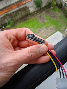

Well, not my PC itself, sorry if it looks like a clickbait.

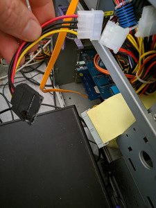

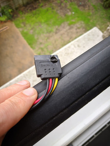

A Molex to Sata adapter that was hanging in air, still plugged in the Molex. it's a PC I sometimes use booting Acronis to clone OS and disks. I was not using the PC for that purpose so the adapter wasn't in use.
It used to work without any issue. I didn't change anything and it happened suddenly while the PC was powered on since 5mins or so.
It made actual flames, I could hear it taking fire, but the PC seemed to work before I unplugged the PSU.
I didn't turn it on again yet.
I have no clue on what could have caused this, especially since it was not being used. Maybe something metallic stuck in the Sata port ? It would be strange anyways since it's hanging this way since weeks with the PC turned on sometimes all day long.
Not sure what to do now. Any advice ?

Yes, throw away these SATA adapters and buy proper ones. It's a known issue, give me a min and I'll find a reference on this forum of what a "proper" adapter is.

Thank you, it's "good" to know that it's a known issue with these. I was feeling slightly traumatized to be honest.

Did it at least "halt" first?
J/K, I have had this happen. Those adapters are terrible.
No everything was behaving normally besides the adapter taking fire.

Maybe cheap and nasty metal used for the pins in the plug, that "splintered" and created a metal whisker when it got plugged into something. Think what happens when you put steel wool on a battery's terminals...
