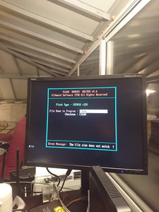

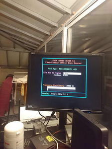

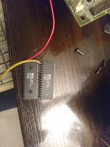

Hello vogoners, I am trying to revive my trusty soyo 6ze+ because it is a Soyo, and unfortunately while it was decommissioned in Working state, I found it trying to boot in boot block mode. It asks for a bios file and I tried successfully programming the bios using awdflash but the mobo does not post at all. I tried to program the bios on another mobo by hot plugging it and even though It was a successful task using uniflash 1,40 the motherboard posted correctly one time with some destroit colours and on every other try the mobo booted in boot block mode. The original bios chip is a mx28f2000tpc and I tried with the same outcome a winbond 49c020. It seems that the rom stored on the bios chip gets destroit. I measured the vcc to 5v and vpp to 12v. What else could cause a rom getting destroit? Any clue out there because it is a Soyo?
