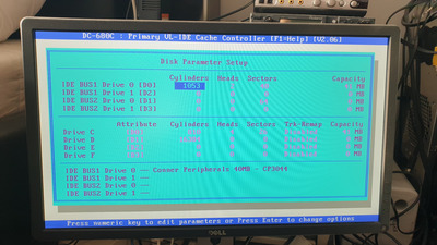

The screenshots you show look like the configuration utility considered the current configuration invalid, and started with all settings as default. This is not unexpected, as you suspected a corrupted configuration EEPROM all along. Did you get asked the question whether you want to save the configuration before you rebooted? And did you answer "Y" to it? In case you use a german keyboard, you need to press the Z key to answer "Y".

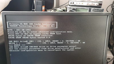

Reply 21 of 26, by mkarcher
I found the issue why the method I suggested didn't work properly. The code at that point I told you to jump to expects the DS register being set to the base address, as well as the CS register. So I extended the suggested debug invocation by the command to set DS to 5000 as well. The G command will set CS to 5000. If DS is wrong, the setup code doesn't receive the correct base address 1F0 of the controller. The all-zero setting you observed is also displayed if communication with the controller fails completely.
A:\>DEBUG
-nDC680C.FRM
-l5000:0
-rds
DS 1234
:5000
-g=5000:1939

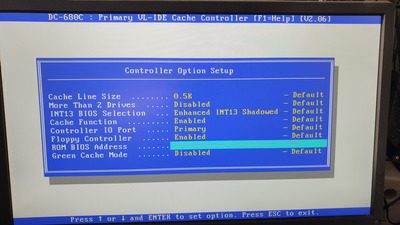

Thank you very much, already work the controller.
I make suggested orders in dos, at settings i fix hdd settings, and the rom bios adress setting was corrupt. I fix it with change to default settings.
After restart i see the f2/f6 enter settings post, and i can enter.

The corrupt settings were stored in the 64-byte EEPROM. After you saved valid settings with the setup tool, the corrupt settings are overwritten. If the issue doesn't reappear, no further action is required.
The message "IDE BUS1 drive0 (D0)BAD drive or drive parameter error!" means that the drive rejected the parameters "2 heads, 40 sectors" when the controller told the drive to use that configuration. While this is listed as the "native geometry" of that drive, it is quite possible that the drive only accepts the parameters listed as "translation", which is 980/5/17. Using the drive while this error message appears on boot will mix up data on the drive and cause spurious errors. You need to configure the drive in a way that this message does not appear, then you should re-format and re-install to get it into a clean state.
