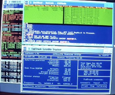

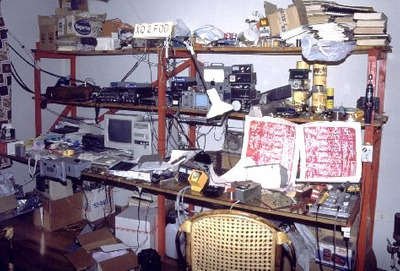

Hamby wrote on 2023-01-22, 20:56:
2D acceleration will be important because one of my amusements is networking my old systems, and I'll want 2D acceleration for Desqview/X (assuming it even supports 2D acceleration) to access my Linux box. I don't expect to do anything productive with it, however.
I'm not sure, but maybe the author of FodTrack has some tips for DesqView/X.
This radio amateur used DV/X in the 90s on his PC for satellite tracking/Packet Radio.
For real work, in other words.
His current callsign is XQ6FOD and his last entry on QRZ.COM was from 2021.
So chances are good he's still with us.
https://www.qrz.com/db/XQ6FOD
https://www.qsl.net/xq2fod/Radiacti/Radiacti.html
    62.86 KiB
    974 views
    Source: https://www.qsl.net/xq2fod/Radiacti/Radiacti.html
    59.28 KiB
    974 views
