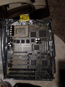

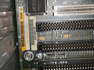

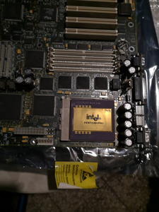

Hello all, I've recently got a a DELL 09439 motherboard for a Pentium PRO system I'm building. I'm trying to find the manual/specs/schematics for this one so far I had no luck can anyone point me to right direction ?
attached are the tags found on the mobo as well as the mobo itself.
Thank you in advance

Reply 2 of 19, by Horun
The AA sticker looks like an Intel board sticker. And appears to be the Intel 450KX chipset.
probably like this: https://theretroweb.com/motherboards/s/dell-d … mension-xps-pro___
Or maybe this: https://theretroweb.com/motherboards/s/intel- … mance-au-aurora

Reply 4 of 19, by TonyStark
Thank you for your information, although I find it a bit strange on the front end connectors, that the board does not have a power on marking...it has a rest, led, speaker and sleep ? ....does anyone know ? I'm trying to find a manual or a diagram layout of sort...

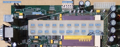

Reply 7 of 19, by Dorunkāku
The power connectors and fan connectors pinout for the Dell Poweredge 2100 look the same.

Reply 8 of 19, by luckybob
Looking at that connector. between the base OEM config and the dell... I would wager highly, if you were to move the ATX connector on the motherboard to the other side, it would likely be compatible with "standard" ATX power supplies.

luckybob wrote on 2023-01-23, 17:42:
Are we 100% sure that these pinouts are the same with my motherboard ? is there a way to check my motherboard's pinouts ?
Reply 15 of 19, by Dorunkāku
You could make your own adapter. Buy a 20 Pin Motherboard to 24 Pin ATX Power Adapter and rewire the 20 pin side using the 'staple method'.
That would cost about 5 or 6 euro.

Reply 19 of 19, by Horun
TonyStark wrote on 2023-01-27, 22:44:
Yes there is a way ! Use a DVM set to ohms and check the pins on the ATX style connector to known voltage pins in the ISA and PCI slots. The Grounds, +5v, +12v, -5v and -12v should be easy.
https://old.pinouts.ru/Slots/ISA_pinout.shtml and https://pinoutguide.com/Slots/PCI_pinout.shtml
The 3.3v should also be fairly easy to trace.....they should be a few ohms or less for each.
