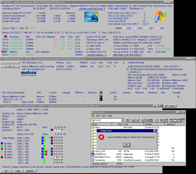

When I install SP6 it's usually the SP6a update, but it looks like there is no q246009i.exe for NT4 terminal server.
I have a q246009a.exe from 27-Jul-2009 which I must have used when I installed SP6 on my Alpha and noticed it was missing (SIV will report SP6a when it's installed). I just found q246009i.exe and tried to install it, but it won't install 🙁
file.php?id=156300
For now I have installed a Matrox PCI G550 and suspect this is as good as things will get.
Does anyone know if q246009i.exe was released for NT4 terminal server and it so where it's available from please?

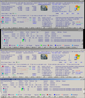

I felt I would try a Intel Pentium Extreme 840 (Smithfield) so I did. As expected NT4 only used the two cores with 2003 using all 4 CPUs.

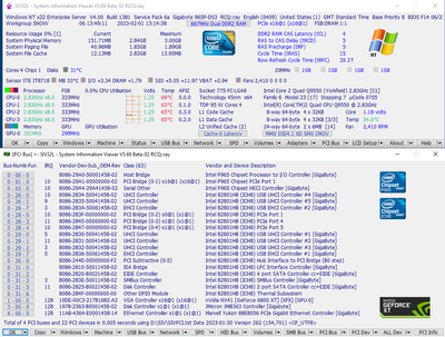

I wasn't and as it looks like it's not available for Terminal Server I installed Enterprise Server which allows 8 CPUs 😀. I tried both 71.84_winnt4_english.exe + 77.72_winnt4_english.exe with my nVidia NV41 [GeForce 6800 XT] and both usually trigger spontaneous reboots and then they didn't then the NV4 service caused a BSOD.
file.php?id=156336
PrtSc does not work so I generated save files then used them to get the screen shot on my development system.
