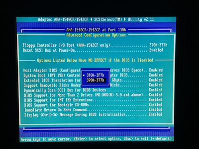

got a 486 class setup here. Two floppy controllers: one on my scsi card and one on the motherboard.
I can change the address of the scsi card fdd controller but can't seem to get all to work right under win 95
should I try the xt-fdc bios? or how are you doing it? I don't wanna use a floppy switcher. but that is another option.

Reply 10 of 16, by Sphere478
The scsi controller does allow me to change the floppy address

Reply 12 of 16, by Sphere478
douglar wrote on 2023-02-01, 04:36:
If you have VLB, there is the promise DC4030VL
https://www.arvutimuuseum.ee/th99/c/P-R/20573.htm
Isa expansion ports only unfortunately

AHA-1542CF handles DMA/IRQ sharing fine. I've used it in this setup.
Thinkpad Dock I with a 5.25" floppy drive
The onboard FDD controller of the docking station cannot be bisabled. I have 1.44 drive on one controller (port 3F0h), and the 1.2 on the AHA-1542CF on port 370h. All works with dosfdrv.sys
