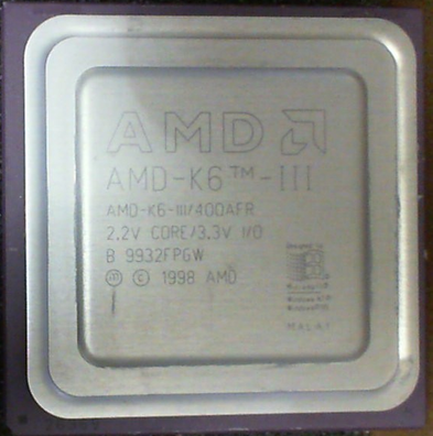

Reply 24 of 28, by red-ray
Chkcpu wrote on 2023-02-16, 20:23:
K6-III Model 9, CPUID 0590, 250nm, 2.4V (has the x2 -> x6 multiplier remap)
I just noted SIV thinks it's 2.2V rather than 2.4V and https://en.wikipedia.org/wiki/List_of_A ... I,_250_nm) also says 2.2V, which do you think is correct?
file.php?id=157905
My CPU has a CPUID of 0591.
Thank you for the link, I have asked Fritzchens Fritz for SIV save files and will adjust SIV once I get them.

Reply 25 of 28, by Chkcpu
red-ray wrote on 2023-02-18, 17:41:
Most regular K6-III CPUs were 2.4V (K6-III 400/AHX & K6-III 450/AHX) but some were 2.2V parts (K6-III 400/AFR & K6-III/AFX), but those where less common. The K6-III 333/AFR was always a 2.2V CPU I believe.
https://www.vogons.org/download/file.php?id=157905 […]
file.php?id=157905
Okay, CPUID 0591; I was not aware of this K6-III stepping. Thanks.
Jan
