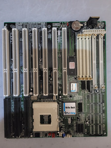

I recently bought a Socket 3 motherboard, it looks very different to garden varieties of mobos. It has 2 chips marked "Write back chip" and I can't see any Cache memory on it. It is a VLB board and supposedly supports 3.3v cpus. It has 4 ISA and 3 VLB connectors. All ISA ports are white. In one corner it says V6.1 which I am assuming is the revision of the board. On the bottom side it has P&Q mark. Can't find anything on Google. Any info on it would be awesome. Picture attached below. Thank you.

PC Chips M912
https://theretroweb.com/motherboards/s/pcchips-m912-v6.1-486
You know it just has to be PC Chips when there's a "Write Back" sticker on a board with no cache.

Yes a m912 v6.1. It has no cache, too bad is not the v1.4 or v1.7 as they came with sockets and mostly had real cache......
added: You can use the v1.7 jumpers settings iirc: https://theretroweb.com/motherboards/s/pcchip … 7-486#downloads
