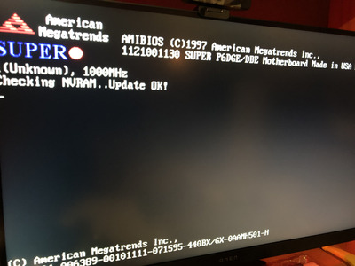

I am trying to make a P6BDE 3.0 work with Tualatin CPUs.

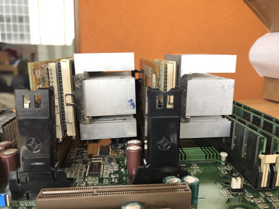

I have two S370-DL adapters and two LinLin adapters.
I put both of them as you can imagine, attached the ugly result.
Forced 1.5V on LinLin and set AUTO on S370-DL.
A boot was obtained but with only one cpu and with the screen freezer on what you see attached.
To my disappointment, I discovered that one of the two SL5XL is not functional…
EDIT:
Actually on a 370DLE with LinLin it works (gives the same screenshot anyway, no microcodes, but the post complete).
So my suspect is that with two functional chips I would obtain a partial post as the attachment.
But let’s face one problem at time.
Can someone put Tualatin microcodes in the bios? I am sure it would post ok with proper microcodes.

Reply 5 of 20, by Mamba
-We are talking about dual slot motherboard, so two CPUs are involved.
-I have two Tualatin-S cpu, I was thinking one of them was faulty.
- The motherboard hangs at post (with one Tualatin installed), exactly with screenshot attached. It stops there.
- The motherboard works normally with only one coppermine installed, no terminator needed. Posts and loads OS.
-Forget about the “faulty cpu”. It is not and the request is not about it. The cpu works, both cpu work. Please let’s focus on the request, if possible.
Reply 6 of 20, by Grem Five
rasz_pl wrote on 2023-02-25, 13:26:
>The 370DLE had exactly the same behaviour, same screen showed at post, with the cpu I was thinking was dead.
>Then with bios update it works.
and why would you think a cpu that shows a post screen is dead? Because it says "unknown"?
I'm guessing they think the 2nd processor was dead because in the boot up screen it should say 1000MHz x2 if it is detecting both processors.
For the OP - Best way to double check is for them to test each processor by itself in that board and make sure they both boot. I would force the voltage setting through the S370-DLs instead of through the Lin-lins and I'm kinda surprised it posted at all, I would reseat you Lin-lin adapters as they dont look fully seated.

Reply 8 of 20, by Mamba
Thank you but… The chips work perfectly.
Please don’t stick on the dead cpu thing. It is not.
They both work in 370DLE motherboard.
I know the P6DGU attempt but here is different. On the P6DGU he obtained nothing, black screen.
With my P6DBE I see a partial post (it hangs), exactly like it did with the S370DLE before bios update.
So again, only to put Tualatin microcodes is not enough, the bios must be modded further probably to eliminate other limitations it may have (whitelist?).
I am asking bios modders here (Ami)

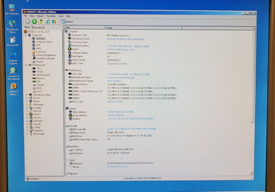

Reply 19 of 20, by Grem Five
Mamba wrote on 2023-03-04, 12:18:
For unknown reasons I cannot enlarge your picture not even on imgur.
Could you add here?
It is on a P6DBE?
Nope its a P6DGS
