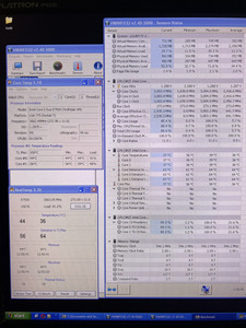

Reply 2 of 17, by xbit
dr_st wrote on 2023-03-25, 20:44:
Well, what are they showing? Is it consistent?
Stuck sensors were a thing, but both cores and main package at once? Not very probable.
Yes, very static. I'm running 7zip bench in the background. The CPU utilization works fine but temps don't change.
    1.33 MiB
    586 views

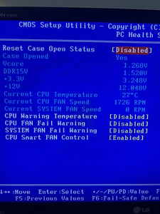

Reply 3 of 17, by xbit
I am seeing the CPU change temps in the Bios.
    81.86 KiB
    578 views

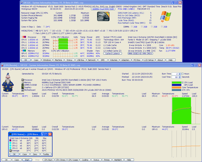

Reply 6 of 17, by red-ray
I just checked one of my Core 2 systems and when I 100% load the CPUs the temperatures gradually increase and plummet when the load is removed.
file.php?id=160797
I find it's much easier to see what is happening when you have plots of the % CPU load and temperatures.
    91.48 KiB
    537 views

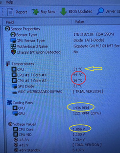

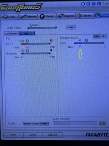

Reply 7 of 17, by xbit
Thanks for checking but sadly, mine is stuck. I see my motherboard/chipset temp changing when i stress the cpu but core0 and 1 just sits. I see it changing in the bios and using gigabytes winxp overclocking tool but not core temp, HWiNFO, Realtemp.
    664.95 KiB
    520 views
    98.59 KiB
    520 views
    102.56 KiB
    520 views

That's a great tool that i forgot about, thank you. Still a no-go. I even re-installed XP and tested before I installed any of the gigabyte chipset drivers/etc. When i stress the cpu i know the bios is seeing it because the cpu fan will rampup and also the one tool that can read the cpu temp is the gigabyte overclocking tool easytune6.

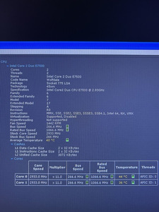

Reply 13 of 17, by xbit

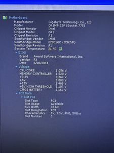

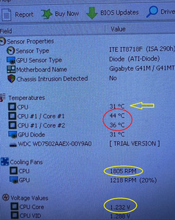

Using AIDA64 still shows core1 stuck at 44 and Core2 stuck at 36 just like the other tools. But, AIDA64 also shows the overall view of the CPU that DOES change. So, that's some progress 😀
    383.07 KiB
    384 views
    356.06 KiB
    384 views

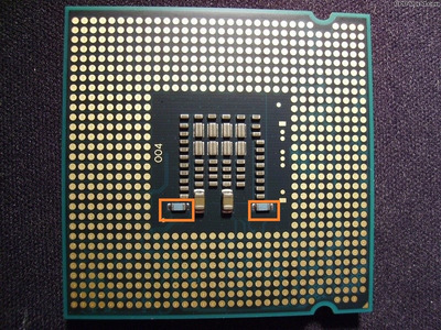

Reply 16 of 17, by bogdanpaulb
The selected smd's are part of the temp sensors for core 1 and core 2. Any damage to those sensors or the traces will lead in to 'locked' values/readings. The overall cpu temp (same as the bios) is using another sensor which is less precise but good enough. Also there were some problems with the thermal diodes on early shrieked 65nm to 45nm designs, which e7500 is (45nm).
    219.3 KiB
    256 views
Reply 17 of 17, by xbit
Great info, thank you! And that's pretty much exactly what was happening. The bios would still ramp up the fans when stressing the cpu but i could not monitor the cores. It's still a great chip that overclocked well.
