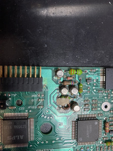

Reply 37 of 42, by CharlieFoxtrot
Ozzuneoj wrote on 2023-03-29, 19:46:
Are they surface mount caps?
There usually can be several different type of drives and from different manufacturers in these systems. AFAIK a FRU number can have drives from different manufacturers, so FRU isn't necessary unique in this sense. Because drive models can be different, it also means that the amount and specs of capacitors can vary too although what I've seen, yes, they use SMD. Ardent tool has a list of models and drives (as well other useful info), although I can't say if the list is complete:
https://ardent-tool.com/floppy/floppy.html#Floppy_List
For example, my 35SX has 1.44MB Alps drive with 9 caps. To change all caps in this drive, you need to remove the control board, because control board caps are on the top side, so you can't access those caps with drive fully assembled. Another thing to note is that the three caps in the motor board and closest to the floppy slot are of bi-polar type. Here is my drive disassembled, but before the recapping. Pretty much all caps had been leaking, although it wasn't a huge mess and there was no corrosion on the boards, at least yet:
Control PCB:
417.83 KiB
293 views
Motor PCB:
411.63 KiB
293 views
My drive wasn't reading disks anymore before changing the caps and you can consider yourself lucky in this sense. However, what I've read about these capacitor issues, people were recapping these drives already in the early 2000s, so it could be possible that yours has already got new capacitors at some point.
