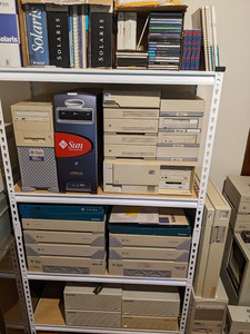

I can probably answer more specific questions or provide further detail on anything if required as this is all quite fresh in my mind right now. I'm currently going through my SPARCs trying to fix what doesn't work, then benchmarking and installing Solaris on what does work:

Reply 6 of 6, by drosse1meyer
davidrg wrote on 2023-03-30, 21:39:
Good info
Also that's quite a collection 😀
