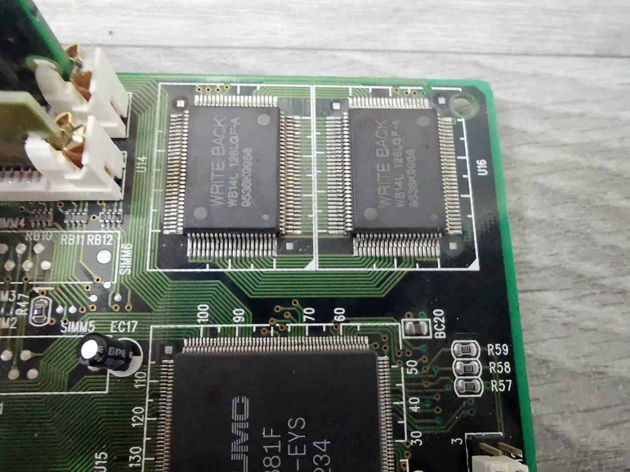

From what I know, fake chips on some 486 boards were just dummy chips: a DIP package that had no function inside at all. They were there to trick people to think there was L2 on the board.
The other kind of fake chip is where the reseller puts a new coating on the chip with a new print. It's often a cheap unrelated part that they try to sell as a more popular chip for profit. Your chip might not work at all, in such a case. Or, it is a cache chip but of a lower capacity than was advertised.
Some BIOS could report the cache on boot, even tho you have none installed. It then just echoes whatever you set in BIOS.

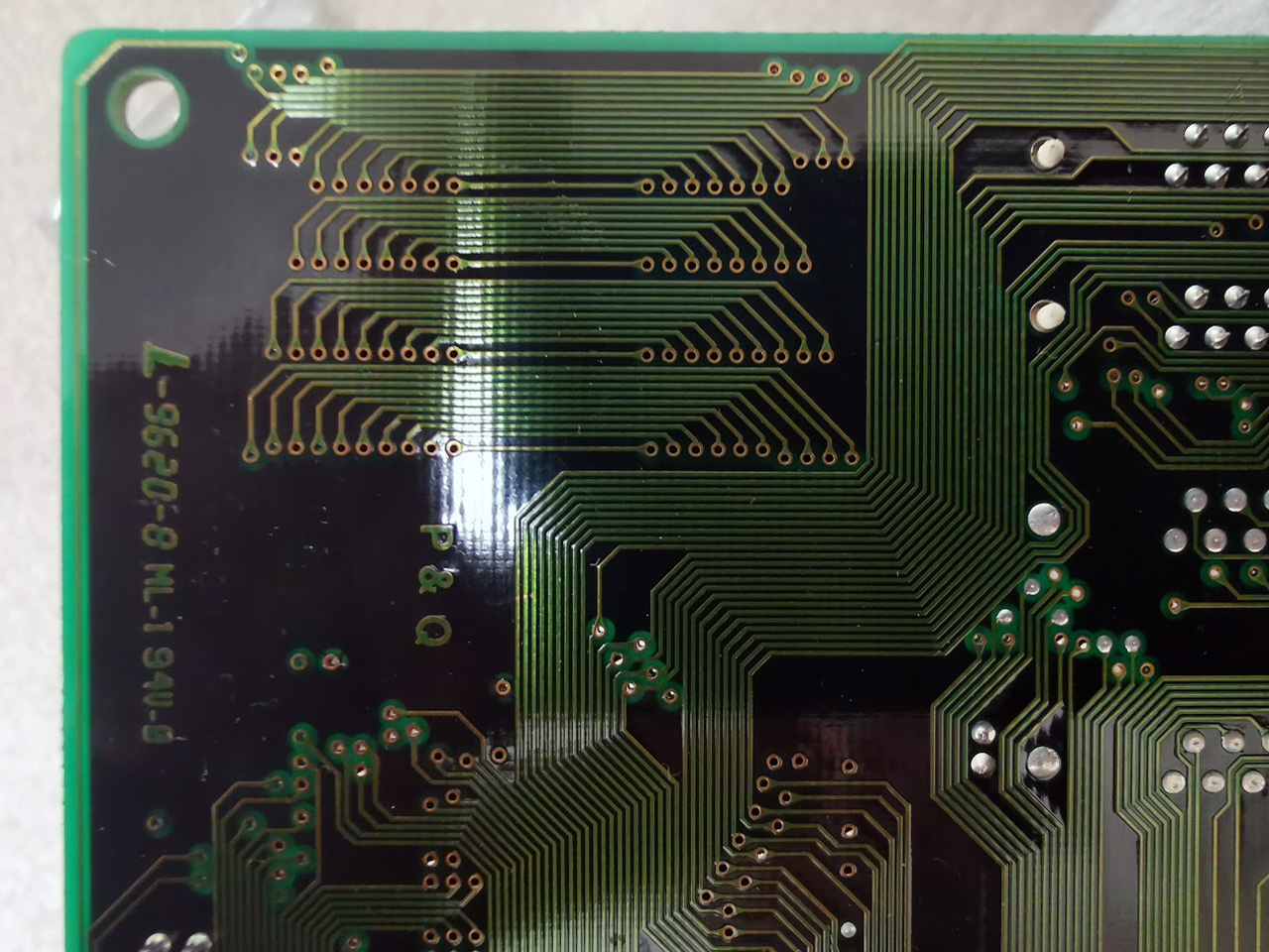

Reply 2 of 16, by paradigital
Hezus wrote on 2023-04-13, 21:14:
Yep, like on my PCChips M919.
And the traces on the back, which are hilarious:
Fortunately I own a cache module for it, so mine actually has cache.

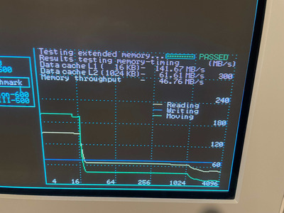

Reply 3 of 16, by Jackhead
So here my speedsys membench. It says i have 1MB, cachechk say i have nothing.
That means cachechk cant read out my hardware correctly?
1.06 MiB

Reply 4 of 16, by CoffeeOne
Jackhead wrote on 2023-04-13, 21:34:
Hi.
Sorry, but 🤣.
You use the Asus SV2GX4 board, that board does not report wrong cache sizes.
So when the boards shows 1MB L2, you have 1 MB L2.
So cachechk is just wrong. speedsys clearly shows that it is real 1MB L2 cache, too.

EDIT: To be more precise, you L2 cache is NOT running on 2-1-1-1 read and 2T write. Do you have 2-2-2-2 read?

Reply 5 of 16, by mkarcher
Your RAM is too fast (or your L2 is too slow, depends on the point of view), so the speed difference between cached reads and non-cached reads is too low for cachechk to pick it up. Try adding RAM wait states in the setup, and see whether cachechk then recognizes the correct amount of cache.

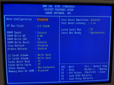

Thanks guys! Here my settings, maybe you see what i can improve here.
So I need go up WS, or cache w/r. I have 15ns cache . And Rams are 60ns.

Reply 7 of 16, by CoffeeOne
Jackhead wrote on 2023-04-13, 21:51:
Cache Burst Read should be 1T!
Also change Slow Refresh to Enabled. Slowly refreshing the DRAM means a faster performance. But minor improvement.
Cache Burst Read is important.
EDIT:
Interesting would be also setting local bus values to T2 and Transparent.
You have to check, if the computer is still stable then. No guarantee 😁
But you could beat my ARK 1000VL 27000kB/s value in speedsys. Maybe.
Reply 8 of 16, by Jackhead

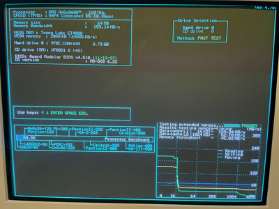

Here we go:

Reply 9 of 16, by CoffeeOne

Great.
Now try T2 and Transparent. Graphics speed would be higher. Keep in mind, that you have already good graphics speed.
Reply 10 of 16, by Jackhead
When i set Transparent system dont boot. Hold after memcheck. With T2 only i see no difference on bandwidth

Reply 11 of 16, by CoffeeOne
Jackhead wrote on 2023-04-13, 22:11:
Yay, then keep T3 and Synchronize.

Yes, I was looking at moving 🙁 . Its ~45 to ~67, weird that cachechk doesnt pick it up
Reply 16 of 16, by mkarcher
rasz_pl wrote on 2023-04-14, 10:53:
When the OP stated that cachechk doesn't pick it up, L2 timings were bad (2-2-2-2 instead of 2-1-1-1), and it went from 45 to 53, which is a smaller difference than what you see now.
