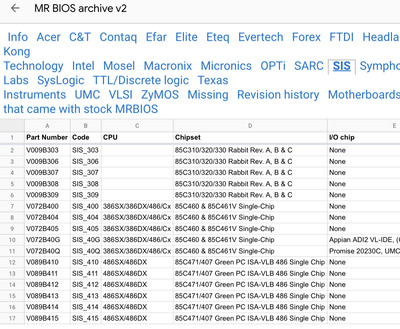

Reply 8 of 21, by Babasha
Hi!
Here some SIS471+404 Mr.BIOSes - https://docs.google.com/spreadsheets/u/0/d/1v … eyuFf8/htmlview#
Here the Mr.BIOSes archive - http://vogonsdrivers.com/index.php?catid=77&menustate=32,29

BIOS versions
Reply 10 of 21, by GigAHerZ
@Babasha, did you check the contents of the links, you are sharing, yourself? There are no MR BIOSes available for almost any 486 class motherboards, including SIS471.

Reply 14 of 21, by Babasha
GigAHerZ wrote on 2023-04-21, 06:32:
Im flash 5-10 motherboards to/from Mr.BIOS (386 and P1). Sorry I dont check every file/BIOS in Mr.BIOS archive.
