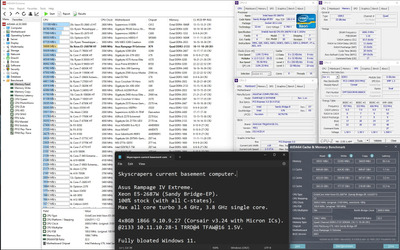

The first generation Elpida Hypers is the fastest DDR3 memory ever made but the lifespan was about 6 months on average, much shorter if pushed to the limit. The second generation Hypers while still fragile (and a smidgen slower) was much better when it comes to lifespan and my quad kit of Dominator GT 2000 (8 8 8 so not a top bin) is still alive and kicking! 😁
But no, they are not worth the price these days. Except for extreme overclockers (a.k.a the people inflating the Hyper prices) most people want modules larger than 2GB.
I usually find the (on paper) slowest 8GB modules to be the best choice for the money when it comes to speedy DDR3! 😁 8GB modules with Micron chips usually can't do as tight primary timings as Hynix and Samsung but every kit I have tried can do TRRD 4 and TFAW 16 even at 2133++ MHz some even at 2400 MHz and they will usually also let you set TREF to the highest value. Some tasks prefer low latency mostly affected by the CAS and "Command Rate" timings others like throughput mostly affected by TRRD, TFAW and TREF.
This is what I'm running in my "basement computer". The system is pretty speedy considering the CPU is running @stock and that Sandy Bridge-E launched Q4 2011.

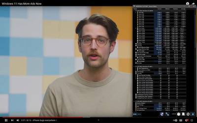

Stuff like decoding Youtube 4K (downsampled to 1080 because of the monitor) is hardly enough of a CPU-load to even register in the monitoring software.

I paid 300 SEK for the above Micron memory kit so about 27 euro.
