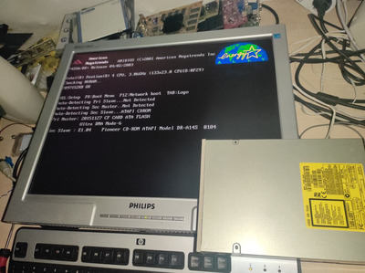

I recently bought a Pioneer DR-704S:
92.7 KiB
305 views
but when I connected it to the computer it was identified as a DR-A14S, I searched for this model drive and it proved to be a not so reliable more recent Pioneer drive rated as 36x.

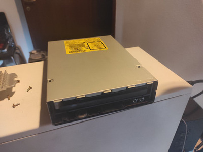

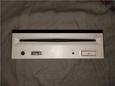

So I took off the front panel and:
90.51 KiB
305 views
Two buttons ah? It really seems like this one!

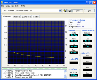

So I took the cover with the label off, inside it was a mess, it was full of dust and hair, I cleaned it as much as I could (due to the slot in mechanism the drive inside is less accessible), and then gave it a try with nero cd speed:
41.21 KiB
302 views
Anything I can do to improve the performance? Clearly something is wrong with this drive, I also tried to find an updated firmware but without luck. When I cleaned it I also used a cotton swab with ipa to clean the lens.
Also Nero CD Info is unable to read the true speed of this drive, it asks for a cd to make the chek but when I put one in it says it can't read it.

Not really deceitful tho...the DR-A14S (Pioneer branded) & the DR-704S (OEM) are the same base units but with different bezels, so firmware may be shared also - they even have the same (DR-AI4S headed) manual (which also covers the DR-714S)

So it's a 36x? Why it doesn't read a full disc faster than 17x then?
The weird behaviour is clearly evident also from the p-cav guess of nero cd speed.
After cleaning the inside with compressed air, clear the laser with a cotton swab and ipa I wouldn't know what else to do.
I also tried a 700mb cd-r disk the speed is the same, apparently the laser is particulary sensitive (or weak) since during the reading it slowed down 3 times.
