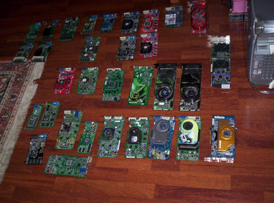

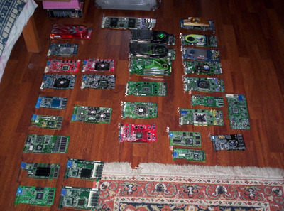

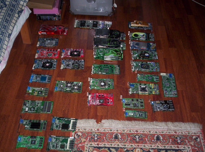

old stuff(part of the collection , maybe we can find cooling that fits?) :
My 80486-S i66 Project

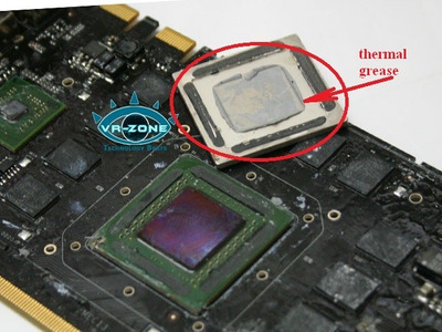

Reply 3 of 11, by shevalier
ediflorianUS wrote on 2023-05-15, 12:00:
Second option would be to attempt a repair on 8800GTXs I have , one use to boot w/artefact's , but today did not.
A legendary performance card with a legendary idiotic heat spreader.
Look for a new chip, remove the heat spreader from it, solder it to the board, adjust the cooling system for thermal contact.
Suicidal mission.

Reply 6 of 11, by shevalier
ediflorianUS wrote on 2023-05-15, 18:25:
I always remembered it was the chip itself (gray).
Gray and fried. Alas.
These chips are all on thermal paste, not solder.
Aopen MX3S, PIII-S Tualatin 1133, Radeon 9800Pro@XT BIOS, Diamond monster sound MX300
JetWay K8T8AS, Athlon DH-E6 3000+, Radeon HD2600Pro AGP, Audigy 2 Value

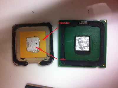

Reply 8 of 11, by shevalier
ediflorianUS wrote on 2023-05-16, 07:55:
These images seem to sugest tiny solder balls (BGA) .... not paste .... oh well who knows.
Thermalpaste, not solder paste 😉
For example, some P IV
Low-melting solder (gallium-based)
