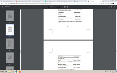

The quality was generally bad on all of their boards, around that era, for me it was the https://theretroweb.com/motherboards/s/ecs-k7vza-3.0 , the black pcb variant from Mercury (Kobian/Mercury KT133a FSX), caps were terrible and it eventually died (due to my fault also, improper storage/heavy corrosion) but still have it in my 'parts' bin. The nice 'quirks' of the board were decent fsb266 support (stable) and the presence of the sound blaster emulation option in the bios (it has a vt1611a sound codec and the vt82c686B southbridge) other then that, the bios was 'poor' in OC/Speed related options as their boards usually are.
