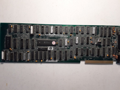

Hello, does anyone here know what card this is and have better pics of it please?
I’m trying to replace some components, but they have been wiped out rendering the card very hard to repair!
Reply 1 of 11, by the3dfxdude
It looks like a Twinhead CT-6020AN but with a different silkscreen. I guess it's a pretty common board layout, that may have been sold by many companies all from the same Taiwan manufacturer. It uses alot of standard logic. What components are bad?
Reply 2 of 11, by Gandalf 75
Hello and thanks for the reply!
I was about to have a look and troubleshoot with an oscilloscope, however some ICs on the board have had their number/model number wiped out by - i guess - time?
They are completely unreadable (even with a microscope) so was wondering if someone here had the same card and could kindly post some pictures to allow me to identify what ICs there are.
Currently the screen is garbled when powered on together with my 5160.
I am suspecting one or more RAMs, but have no clue which ones they are as lots of codes have been removed from the chips.
Reply 3 of 11, by Mandrew
That's the problem with Chinotaiwanese clones, there are hundreds of "noname" small time manufacturers producing the same hardware with little to no modifications to the original hardware they stole/copied from, often reusing leftover parts sold by their business partners that went bankrupt. They don't print labels to keep costs down so these are nearly impossible to identify. I have 8 MDA monitors under different brand names with identical case and chassis.
Just replace the RAM with known good ones, they go bad quite often.
Reply 4 of 11, by Gandalf 75
I unfortunately don't know which ones ARE the Ram ICs at this stage, as there are some ICs without any writing on them.
I can sort-of guess that they are the ones that have specific common lines, but what if I'm wrong?

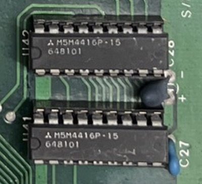

Reply 5 of 11, by root42
Gandalf 75 wrote on 2023-06-02, 09:48:
The 4416 are the RAM Chips. However I would rather go a bit more systematically in diagnosing problems with the card. Do you have an oscilloscope? I would start probing clocks and outputs of the 6845, traffic on the RAMs data and adress line, looking at the logic chips.

Reply 6 of 11, by Gandalf 75
I totally agree with you, however in order to troubleshoot the logic chips I would look at their data sheet, but how can I do so on ICs like these?

Reply 10 of 11, by the3dfxdude
Personally, I would get a schematic of a CGA card like IBM's, and identify the obvious key components and check for sync and color signals. You could do this without a picture of a card, and probably can figure out what the ICs in question are even though they are blank!
But if you would like, here is my version, but you notice that with all the standard logic, they'll shove in whatever IC they had in the bin on that day. The thing to note is the boards layout looks identical, and they were made about the same time.
Also, you could stick in a mono card simultaneously with the CGA and boot in mono, and then run debug and fill the CGA memory with 1's and 0's, to find if that is working or not. However, I'm guessing your problem is more fundamental, like no screen? Check the signals at the connector.
Reply 11 of 11, by Gandalf 75
the3dfxdude wrote on 2023-06-03, 22:45:
Thanks this helped a LOT!
