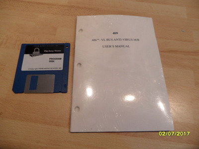

Yes. An 5,25" or 3,5" diskette with utilities.
Like cache check utilities, anti-virus program (as a companion to boot-sector protection in BIOS), external CMOS Setup utilities, etc. Little things like this.
    71.11 KiB
    610 views
    A 386/486 motherboard anti-virus; source: eBay (Lutzis-Allerlei)
