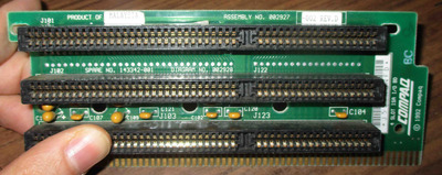

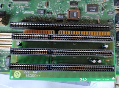

Hi all,
Is there any chance this ISA riser could be made to work on this LPX motherboard, or would I be setting myself up for magic smoke?
In the photo the riser is lying flat on the motherboard next to the riser connector to show the different pin layout.
1.59 MiB
456 views
Mechanically the riser fits the slot (tried without power) and the contacts seem to connect well, except of course where the board connector has more pins than the riser.
I'm not familiar with this stuff, so happy to get any information or recommendation.

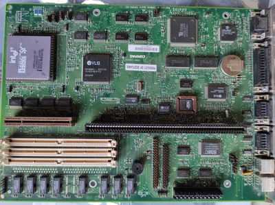

Some background: the riser is from my Packard Bell Pack-mate 486. Its motherboard is in bad shape and has irrecoverable battery damage. The motherboard shown I got secondhand without its original riser. I couldn't find a manual online for it, but I think it is from a Compaq ProLinea 4/66: I can confirm these numbers on the board: spare part 164560-001, Assembly 003760.
1.89 MiB
456 views
Reply 1 of 10, by Tiido
This board needs its own riser, plugging this one in will make the blue smoke escape from multiple locations.

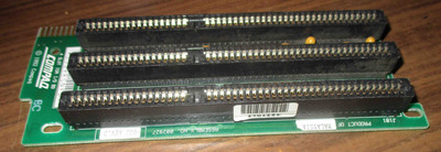

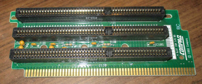

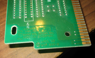

I might actually have a suitable riser, from a slightly different Compaq ProLinea 486. Only problem is that I don't quite know where it is (because I moved to Norway a little while ago), but if I can find it and you pay for shipping you can have it.
Reply 3 of 10, by Tiido
You are in luck, I found the riser, it was luckily not deep in a box but quite near the top 🤣
I expect it to be compatible but I cannot give any guarantees, it did come out of a ProLinea 486/33 with a bit different/older motherboard.

Reply 4 of 10, by dionb
Looks very likely - but to be safe, even if it fits physically, measure continuity between voltage and ground pins on one of the ISA slots and somewhere on the motherboard (eg on the P8+P9 power connectors). If they're OK you know you won't get magic smoke in any event.

That's really great Tiido, thanks for searching! I'll PM you to follow up.
For sure a much better fit than the one I have and I'll try Dionb's suggestion to measure continuity as an additional sanity check.

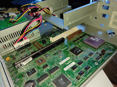

Reply 9 of 10, by pbagain
Thanks so much Tiido for helping out with the riser!
Unfortunately I didn't consider the placement of the Compaq board in the Pack-mate case: the original board had the memory slots all the way on the other side, but now 2 out of 3 memory slots sit just below the metal bracket that holds the floppy drive. Even the lowest profile memory I have (18mm) is too high to fit under. I wouldn't mind just using the one free slot, but it just so happens the slots have to be filled in the other direction for the system to recognize any memory at all.
1.69 MiB
136 views
Now I'm thinking to cut off part of the floppy drive bracket and then I can just run it without floppy drive (even without the bracket I don't think memory and floppy drive will fit at the same time). Please let me know if any of you have a better suggestion 😀
The riser card fits just fine b.t.w., although that may not be apparent from the photo.
Reply 10 of 10, by Tiido
Cutting the bracket or bending it is what I would be doing if that case is going to be used for this board. Unfortunately it seems to be riveted on so it will be pain in the rear in every way 🤣
