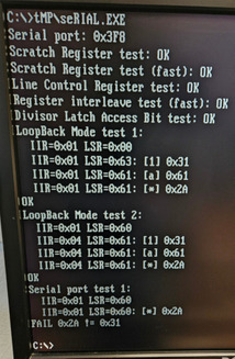

I made some changes to the code last minute and I didn't test it, I will do it tomorrow to make sure I didn't give you a broken program. I want to be sure because the result is unexpected.
It looks to be some sort of electrical problem with RS232 drivers, not with the serial port logic. Usually I'd blame the card but since several were tested, and they work in other systems, it has to be the mobo somehow. Perhaps the 12V (both + and -) delivery to the ISA slots it somehow at fault, but the measurements of the serial port pins were OK...
Just one more question, the photo is a bit small so I can't see it very well, is the last result (before FAIL) LSR=0x60 or 0x68? I'm hoping for 0x68...
That definitely looks like a 0x60 to me.

pshipkov wrote on 2023-06-28, 06:50:
Yes, it is 0.
I see. And this is exactly the same when pins 2-3 are connected (since this particular photo was done with no connection)? I tested the program, it works as it should, although I have also discovered that shorting the pins is not always very reliable, so make sure your connection is good - otherwise it'll obviously fail the test.

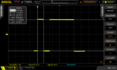

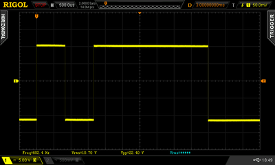

Since I was testing I also connected the scope, here's the results of me using Terminal in NC4, I set COM1 to 1200 7N1 because this is what the mouse uses. Then I've set a single trigger capture on the scope and pressed 'a' key. If you have some time try that and compare what you get . There should be a clean -12V (that's logic 1) and then there is a single pulse to +12V (start bit = 0), then it goes 1-0-0-0-0-1-1 (and another 1 for stop bit, but since all trailing bits are 1 it just goes -12V and stays there).
This corresponds to a = 0x61 (only 7 bits are transmitted) with LSb sent first. Note the voltage levels, low is -11V, high is only about 10V but good enough, clean sharp edges, no noise. If there are any power delivery/quality issues I would expect your results to be much worse.

It looks like the connection was loose indeed.
Oscilloscope result is similar to yours. My reading was slightly more noisy, but i didn't adjust anything before taking the measurement.

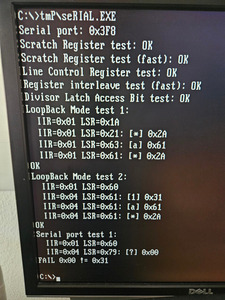

Reply 131 of 144, by Deunan
pshipkov wrote on 2023-06-28, 22:52:
Ah, now we are getting somewhere. 0x79 is much more reasonable status, it means byte received but there was a framing error. I'm going to skip the details and just state the obvious conclusion: start bit was detected, stop bit was not, and all received bits are zero. So that would indicate there is a problem with -12V supply.
Please check the resistance between the power connector and ISA slots. Focus on -12V but check all other rails as well, each one should measure no more than 1 ohm (and preferably a small fraction of it). If the resistance is low, then perhaps there is some corrosion or the power connector pins are bent - I had such cases.
If both the connector and resistances look OK then it could be one of the capacitors on the -12V line being open, or shorted but not completly but more like a zener diode (tantalum caps can do that). But I don't see tantalum caps on your mobo, in fact I don't see any big caps there at all. This also might be a problem if the PSU caps are shot and the -12V line is very noisy. So the last thing to try would be to solder 10uF (anything up to 100 will do in a pinch) cap, temporarily, on the bottom of the mobo between -12V and GND. Preferably near power connector or the ISA slot in which you put the serial card. And test again with that capacitor. Make sure you get the cap polarity correct.
