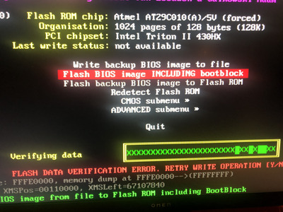

Hello,
I acquired an apparently broken P5A-B.
It powers on but the screen stays black.
Cpu and chipsets both get warm, there is power on agp and pci for sure as well.
Caps look good also.
So I am trying to hotflash it.
Problem is that apparently I can’t.
The chip is an ATMEL AT29c010A so using -FORCE parameter should do the trick.
Not in this case as I get DATA VERIFICATION ERROR (see image).
Any fast suggestion?
The bios chip is definitely correct and so the hex used (1FD5).
I am using my old GA-586DX to hotflash, different chipset but is an hotflash procedure, should not be relevant, right?

Reply 1 of 26, by dionb
For hotflashing two things are relevant:
- the EEPROM needs to be supported by Uniflash and the donor board
- the 'donor' board you flash on needs tp support Uniflash
Apart from that, any differences between boards is irrelvant.
If you are getting data verification errors, either the EEPROM is dead (not implausible!) or the flash is not (fully) supported by the board.
Have you been able to flash anything else on this board? Can you flash the board's own BIOS with Uniflash?
Reply 2 of 26, by Repo Man11
When you're doing a hot swap flash you generally don't press the chip into the socket fully - I've had issues similar to that where it was caused by the chip not quite making good enough contact.
Back in the Nforce days when hot swap BIOS flashing became popular, I discovered the /F switch which: "/F - stands for reprogramming by means of the system BIOS. Most contemporary BIOS's feature the procedure of FlashROM reprogramming. The key /F enables AwardFlash to reprogram FlashROM with the algorithms of the current BIOS version. If a mainboard peculiarities do not allow applying AwardFlash Writer algorithms, you should use the key /F." So you may be able to use Awardflash to do this if Uniflash can't.

Reply 8 of 26, by kaputnik
Got no specific experience of those boards or Uniflash, but if I'm to guess, using the /F parameter will force chip specific erase commands and page mode writing. You might want to try going back to the basics and erase the chip by writing 1 Mbit of 0xFF bytes, and then write the BIOS image byte by byte instead. Should work with any 29 series EEPROM.
The only reason for those functions is time saving when programming large batches of chips. When programming a single chip it doesn't really matter if it takes 10 seconds or a minute.
Also, if it's possible to manipulate the write/read timings in Uniflash, you might want to try to go a little bit slower.
Otherwise I agree that a standalone programmer is a must have for the retro computing enthusiast. My personal recommendation is the XGecu T48, the successor of the popular TL866 😀

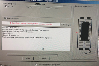

Reply 18 of 26, by Mamba
kaputnik wrote on 2023-10-22, 08:40:
Ah, sorry, was under the impression you got the device ID (1FD5) by reading it from the actual chip with Uniflash. If you can't […]
Mamba wrote on 2023-10-21, 11:59:
Thanks […]
kaputnik wrote on 2023-10-21, 10:50:
The only way the software could identify the chip is by device ID, and that seems correct in your OP, assumingy read with Uniflash. Then it's up to the software to choose programming parameters.
If it's possible to read and print the device ID with AWDFLASH, you could verify if it's read correctly or not. If it is, you can be almost completely certain the problem is with AWDFLASH's routines, not the chip itself.
As a rule of thumb, those old parallel EEPROMs are more or less immortal. They might lose data over time, but it's very uncommon that they go bad hardware wise.
Thanks
But I am not certain I understood your words.
The chip is not recognised by uniflash at all and by multiple awdflash versions.
The only version that recognise it (but not completely so does not complete the flash process) is 5.2B tailored for ATMEL AT29C010A /5V Flash ROM that is exactly the chip I am using (as said, it is written on it).
So, I am not sure how it can be a problem of the program.
Sorry probably my English is not good.
Can you explain?
Ah, sorry, was under the impression you got the device ID (1FD5) by reading it from the actual chip with Uniflash. If you can't read it correctly in any way, then yes, your chip (or something else in the HW chain) might be busted.
Mamba wrote on 2023-10-21, 14:04:
Just ordered this
W27E010-70 DIP-32 1Mbit 128k Eeprom
I hope it will be ok
That's a 27 series chip that needs 12V programming voltage, otherwise it should be pin compatible. Seen a few mobos where you can select different programming voltages with jumpers, but in my experience it's not really commonplace. Consult the manual for your board.
Damn…
I really do not know if my board support 5V or 12V chips.
There is nothing on the manual about voltages.
And I need to take into consideration that we are talking about two mainboards.
The bricked one (P5A-B) and the hotflash board (GA-586DX).
So basically I am walking in the dark with this… And they say hotflashing is straightforward…

That’s it…
I followed your suggestion and got a T48 programmer.
It signaled a bad pin on the chip.
So I assume the chip itself is broken, right?
