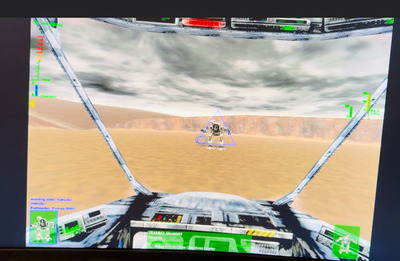

Looking for input on what I’m doing wrong here.
I’ll have to admit, upfront, my D875PBZ is very temperamental. Booting into DOS from 98 or attempting to install a DOS game, wipes the system out. Or really any super hard crash basically soft bricks the system.
As soon as it goes into “DOS Mode” I lose video signal. Absolutely will not reset without a 24 hour power and CMOS battery pull.
Running a FX5900U with DVI-HDMI. Forceware 77.xx.
I have a few games I would like to get working in DOS. Mainly OG mechwarrior and mechwarrior 2. As I’m still digging around how to mod “windows aka pentium edition” and titanium to run at least 1024x768. Tips for that or links would also be helpful.
Is this in issue with DVI itself? Is somehow the card forcing VGA output and that’s why I have no signal? Very odd behavior.
First go around with DOS Mech2 I get a DOS prompt within 98 with the “install graphics” press any key into install, lost video out.
I will add during this time, the keyboard is Completely dead without power. (It has an LCD screen so I know when it has signal) No post images. If you physically “break” the system by pulling ram or The video card it will “beep” accordingly. But absolutely no luck clearing anything until the last drop of energy is discharged from the board. Moving jumpers to “configure” back to normal have no effect.
The next day after it sorted itself out, I booted into DOS from the shutdown menu and got the prompt but realized USB support is non existent (my mistake) and restarted the system. Back to no video out until the “24 hour” mark and things reset. Which is where I am now.
Seems like this is quite the fiasco just to start the system in DOS. Anyone have a workaround or input to why it’s nuking the system?

Reply 7 of 14, by wutang61
Came home today, system was able to post. Went into the BIOS reset the time AGP memory to 256mband enabled full speed USB 2.0, save and Restart and it’s back to no post.
Motherboard is on latest drivers (p34). Very odd. It seems there’s a bug somewhere that’s absolutely breaking the system. I will say, before I F’ed around and found out, it’s been dead nuts stable and predictable in win98. No issues whatsoever with plug and play USB or any 9x gameplay.
The monitor is a CR9 49” ultra wide. It’s able to run HDMI in “AV mode” so it keeps the 4:3 scaling. Actually works remarkably well.
Will try it one more time tonight. But I may need a new board. Just can’t understand what is causing such a massive hang.

I do have an older video card. Actually bought it exclusively for playing the 3D rage edition of mechwarrior 2. It’s an RAGE 2 +DVD.
Using the system for DOS stuff is a fallback. It’s not a must. Just wanted to play with the different versions of Mech 2 including the DOS version. But that game is completely capable of running in DOSBOX with stick support so it’s not a deal breaker. I may have an old LCD that has VGA, but DVI does work absolutely fine when the system wants to post.
It will actually run much newer and unsupported VGA’s with generic drivers in 98. 2400xt will run in limp mode on the desktop with no issues.
I just seem to have an underlying issue. Just can’t seem to find the root problem.
Installing XP hasn’t happened. I would have to “locate” that software. But If I can’t post I can’t do much. Frustrating.
