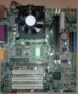

I didn’t know that I couldn’t use polymer ones, so my Aopen S370 now looks like this. 🙁
But the S754 is still nicer under Windows 2000, so the P3-S Tualatin went on the shelf.
technokater wrote on 2023-11-02, 15:20:
I see. I didn't use polymers yet, even though I have read about it. So, the original ones are GSC 1000 uF 10 V 105 C and Stone 330 uF 25 V 105 C. I need to stick to the voltage rating of course, at least not go below, but I didn't see the capacity available with the Würth polymers. For electrolytics I can go higher, but not lower. How is it with polymers?
On such boards everything is usually powered from +5V.
10V capacitors are used to improve ESR. Typically, the higher the voltage, the lower the ESR.
For 8mm - 820uF*6.3V is suitable as a universal capacitor.
For 10 mm - 1000*6.3V.
