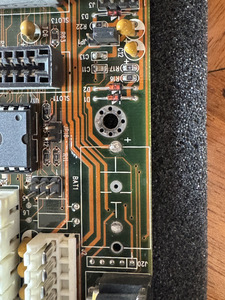

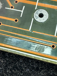

The barrel battery leak only a tiny little bit, but it just had to break this trace.
It’s an unknown 486 VLB board. My question is: Since the trace sits right underneath the battery, does it need to be repaired? Possibly it hasn’t anything to with the battery at all but that’s why I’m asking.

Reply 1 of 11, by megatron-uk
Looks to be going to C11 / R17 ... where do they end up connecting to?
Personally, if that's the only damage, I'd repair it; it looks fairly simple.
(edit: looks like it may be involved with the jumper and/or external battery header and/or diodes preventing recharging of an external battery pack)
https://www.target-earth.net
Reply 2 of 11, by mkarcher
megatron-uk wrote on 2024-03-03, 09:57:
It's not involved with the diodes, even if it is right next to it. The "right" side of R17 is connected to a trace that is most likely ground, as there are multiple tantalums with their negative end at the same trace. If the "left" side of C11 is connected to +5V, this could be a simple power-on reset generator circuit generating an active high reset signal. If that signal is just connected to the obsolete "RESET" pin in the keyboard connector, likely no one cares about it except possibly the very first XT/AT combo keyboards. If the broken trace connects to the board reset logic, it might prevent the system from exiting reset or make power-on reset unreliable (requiring you to push the reset button after power-up to get a reliable boot).
Reply 4 of 11, by weedeewee
Kouwes wrote on 2024-03-03, 06:51:
My question is: […]
My question is:
Yes you need to repair it.
Being underneath the battery has nothing to do with the trace being broken. It might imply how it was broken, but that's it. Nothing more.
It's broken. Fix it.
Do not ask Why !
Reply 5 of 11, by Kouwes
I’m going to fix it, no doubt!
But I am curious what this circuit does. The right side of C11 is ground - it then goes to the tantalums C12 and C14. Then to to some thing with 3 legs Q1.
The other side of the broken trace comes from the underside of the board, all the way from pin 82 of the SiS 85C407 of which I couldn’t find a data sheet.

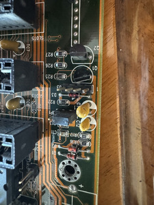

Reply 7 of 11, by Kouwes
@mkarcher:
R17 has no ground on either side.
Look at the onboard battery + side, that connects to D2 and R16? D2 is also connected to R17, C12, C14…
Ah well, I’ll just repair the broken trace.
Btw, no continuity to the reset pin
    1.21 MiB
    285 views
Reply 8 of 11, by mkarcher
OK, I get it now. I have no idea what two tantalums are supposed to do on that trace, though. The idea of that circuit is:
  • D1 is used to charge the NiCd/NiMH battery via R16. The left side of D1 is connected to +5V. The diode makes sure the battery does not discharge into +5V when the system is powered off.
  • D2 is used to pass the voltage from the NiCd/NiMH battery to the RTC.
  • R22/D3 are used to pass the voltage from an external battery to the RTC.
  • R17 limits the current from either battery to the RTC.
  • C11 (with the left side at ground) filters the current-limited RTC supply.
  • pin 82 of the 85c407 is the RTC supply pin. The RTC is integrated in the 85c407.
Without that trace, the computer will not keep settings for more than a couple of minutes, even with an external battery connected to J3, because the supply path from J3 or the NiCd battery to the clock is broken.

rasz_pl wrote on 2024-03-04, 02:29:
mkarcher wrote on 2024-03-03, 17:38:
[*]pin 82 of the 85c407 is the RTC supply pin. The RTC is integrated in the 85c407.
82 looks like #reset? PSTRB hmm power strobe? 86 is power
On that schematic: Pin 82 is part of the RTC part of the 85c407. It is powered by RTC power, but it is not the RTC power pin (which is pin 86, indeed). So R17/C11 on the board of the OP again looks like a "power-on reset generator", as initially suspected, but it doesn't generate a power-on reset for the PC system, but a power-on reset for the RTC. If pin 82 goes from low to high, the RTC is reset (possibly clearing the CMOS, possibly just kicking the oscillator, possibly just setting the "power failed" bit in the RTC status), and this reset happens when you connect an external battery.
