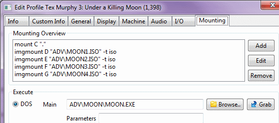

Thanks for the info! I wonder how they are preparing the installation and play for Under A Killing Moon since it came on 4 CDs and how it'll be run, using virtual drive, perhaps?

I think you can set up multiple CD-ROM disc access inside DOSBox's config file. I think there's a thread about it either on Vogons, or on DOSBox's website help section. (I know I've seen it somewhere on usenet.)
Reply 12 of 15, by rcblanke
maybe something like
    17.14 KiB
    1200 views
    mounting
Reply 14 of 15, by Malik
Thanks! That's very informative! I never had the need to use multiple cds in dosbox so far. (Hence my ignorance.)
Reply 15 of 15, by rcblanke
Usually you can just mount multiple CD images on the same virtual drive using a single imgmount command and cycle through the ISOs using ctrl-F4, but UAKM supports the individual game CDs to be in different (virtual) drives. So, once the game is properly configured you don't even have to cycle the CDs anymore.
