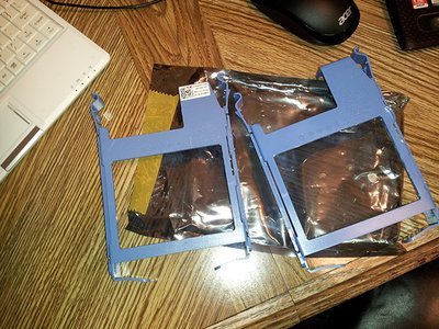

I put a little more work into my OptiPlex 7010, getting it ready to take over the jobs of the two other Windows 7 PCs I have so I can sell them off.

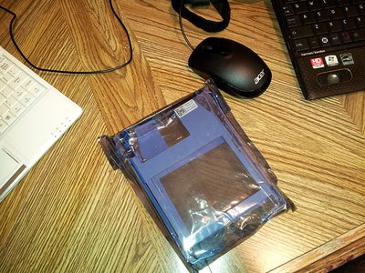

Firstly, my drive caddies came in:
211.77 KiB
2126 views
200.34 KiB
2126 views
^^ I'm sure glad they packed these in an antistatic bag to prevent ESD damage.
When installed properly these mount the hard drive upside-down. Not sure how I feel about that.

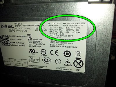

Dell saw fit to equip this thing with a 275W power supply, because it was clearly 1997 in 2014 when they made it. Just as a reminder, this has a quad core i7 3770k with hyperthreading; it is not a low-end model.

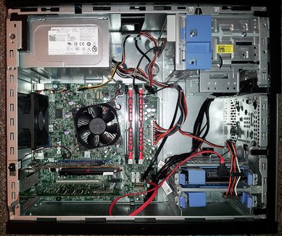

Getting rid of this and swapping the GPU turned into a bit of a project. Here's a before pic:
346.66 KiB
2125 views
^^ Pretty tidy in there, but unfortunately that's not going to last.

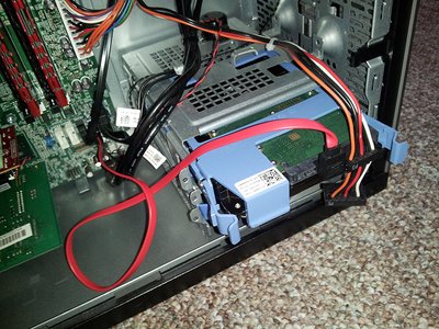

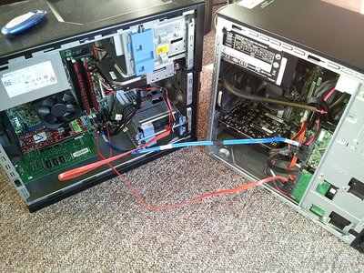

While I had it open, I cloned the drives one of the other PCs in the jankiest way possible:

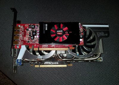

Here's the old versus the new GPU. You can see why I want to upgrade the power supply. I'm actually fine with the performance of the FirePro, but I need it for my rackmount PC. I bought two of these GTX 460s a while ago for an SLI build that failed; they've been sitting in my closet doing nothing ever since, so I may as well use one here.
303.02 KiB
2125 views
This machine will eventually get the GTX 750Ti out of my Core2quad system (on the right, above) but I'm still using that thing for now. This is the kind of needlessly overcomplicated problem that I have all the time & nobody else seems to.

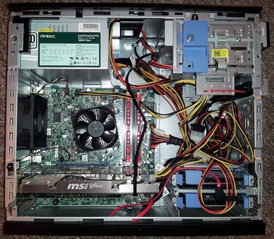

^^ With the new PSU (and GPU) installed. Unfortunately after messing around for most of an hour, I decided there was no way my Antec EA-750 was going to fit (it's physically longer than the stock one by about 3cm, and I had to remove the case door latch to even get it in there.) This EA-380 was the next-best one I had my stash so it'll have to do. It's not a great PSU (these are known for cap deterioration, among other things), and 380W is kind of pushing it with a GTX460, but it seems to be doing the job alright. I had to sacrifice two Molex connectors to get a second 6-pin for the GPU.
Incidentally the GPU looks like it fits in pretty neatly, but it's actually blocking all four SATA ports. Why do they always insist on putting them behind the PCI-e slots?? I can still use them, but I'm going to have to remove the graphics card if I need to unplug or plug anything else in, which is kind of a pain in itself.
Let's not talk about the rat's nest of cables above the hard drive bays.

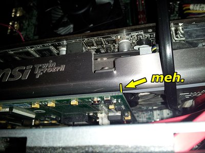

^^ I'm also not happy with how close the two-slot GPU sits to my VisionRGB Pro. It's really only about 8mm away and covers ~75% of the fan area. But I only have one “old-PCI” slot so this is my only option. I really hope it can still suck enough air through that narrow space.

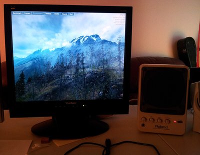

Anyway, with that done & the drivers installed, I left it running Unigine Valley for a while, and it seemed to go fine despite the 380W PSU & restricted airflow. Performance is a bit better than the FirePro, and the GPU temp stabilized around ~66° with the case closed, so I’m calling it a success. Knock on wood.
197.54 KiB
2121 views
BTW this benchmark/tech demo is gorgeous and you can even stop the camera and walk or fly around in it, and play with the weather. I could seriously mess with this all day. I didn’t know about it until this project, but it’s good stuff.
