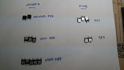

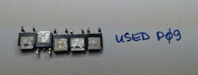

Well, I didn't check thoroughly. Just no shorts and readings were between 11K to 3K ohms on D-S. I just put aside the 3K of the P0906 lot.
P7502 were more consistent, around 9K. My guess, these were mere diodes.
Died as soon as I tried to power it on with cpu. Shorting, I had to desolder the dead ones. All except one line, and that P0906 showed +12 but nothing on the other pins.
Died alone with no load (cpu removed).
Pads were opaque and solder didn't even stick to it despite tons of flux. Really, a lot of flux. I used some deox to help.
I shouldn't have soldered them.
See pics 😀 Markings are inconsistent across, not even close to original.
I bought the first ones showing up, guess I need to buy from the guy that has 100 feedbacks...

That what you get. I knew this for long time.
I was warning all the time about aliexpress, and chinese sellers on ebay peddling semiconductor fakes.
Should had been bought from other sellers that are not chinese or kong hong.
Try again this time from USA or UK. Expense is bit more but you get reliable parts.

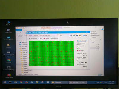

Anyway... For curiosity's sake, I decided to take a closer look at the 2nd generation gaming build's hard drives' S.M.A.R.T. attributes. The build pretty much runs 24/7; this is reflected with those drives' stats.

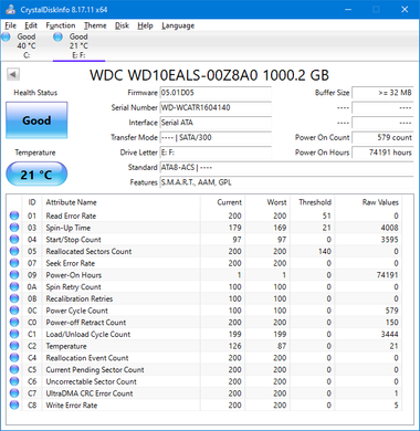

The original dual-boot OS drive, which was my original storage drive... the WDC WD10EALS. Pretty high hour count (still doesn't beat my Seagate 40GB PATA drive in such, though).
50.13 KiB
768 views

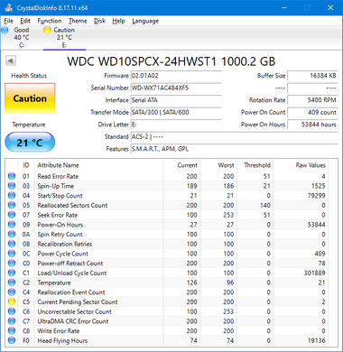

And then, the Steam Games drive, which was Mom's previous laptop drive... the WDC WD10SPCX. Mind you, this was originally a proposed Downloads drive for the 3rd Gen gaming build (which, frankly, I'm glad I decided against doing so). The pending sectors event happened AFTER the migration. Strange luck.
53.99 KiB
768 views
Intel 7600p PCIe 3.0 x4 NVME SSD uses Silicon Motion SM2262, which is a decent controller due to off chip dram for buffer but not true datacenter standard if you are thinking this, it is more of pro-consumer device. With intel behind it for development, that's good choice.
https://www.anandtech.com/show/13131/the-sili … troller-preview
Should started with i5. Yeah, this is true these days you have to spend more but this is because of price had gone up. $1,000 can be done with i5 easily and a used GTX1070 or 1080. Otherwise save up another 400 and find a used RTX2080.

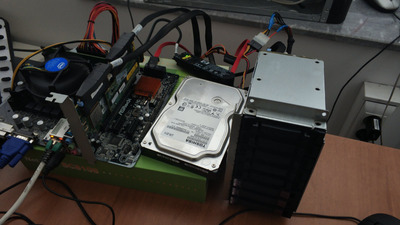

A friend of mine wants home NAS to store some files, but wants it for free if possible 😀 I have many old servers at work, so after some mods HP Smart Array P400 is working in H110M-DVS mobo.

For now, it appears to be some sort of file system error. It was a clone of the HDD I was previously using, initially only as an […]
For now, it appears to be some sort of file system error. It was a clone of the HDD I was previously using, initially only as an experiment to see if it would work. And it seemed to did. Until now.
After repartitioning the drive it seems to be fixed. I'll keep a close eye on how it keeps up.
Looks like the issue starts coming back, though it's in the early phases. Today morning I had an app failing, had to make a boot repair and one corrupted user file, so quickly made backups from the changes since march. Luckily I didn't really move back to the SSD with my user files so there wasn't much to save. The afternoon I'll make a complete disk check then get in contact with the shop about warranty.
Edit:
Yes, it's not as bad yet as back then. Only about 2.3% corrupted blocks instead of almost 8%. Also, I'm starting to lose faith in HD Sentinel. The file system is failing, and it still says everything is fine.

To all on corrupted data issue:
Do not use this utility to scan the hard drive as it takes so long time to do in hours while the hard drive corrupts more data during that, worse, even storage actually die.
When you suspect a data corruption, quickly open the gsmartcontrol utility and query the SMART attributes and see if you have uncorrectable sectors count starting to count up.
At this point, back up the data (too late) actually. You should had backed up data once in while to another reliable storage stuff.
Do not use anything to "save" your hard drive.

My data is safe. I always had duplicates from the important stuff. All that's left to update is barely more than browser data (history, bookmarks). Otherwise I do regular backups each month to my NAS, so there is nothing to lose by checking the drive with HD Tune. My assumption currently is that the drive maybe corrupts data on startups or shutdowns. I had HDsentinel running all afternoon and health didn't move from 98%, same as available capacity in SMARTCTL. IF these are good indications. I'll keep an eye on it over the weekend. Based on repartitioning fixing the issue, I also assume it might be either a controller or a firmware issue.
