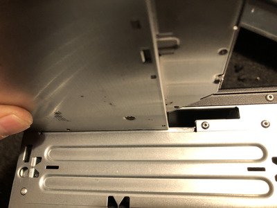

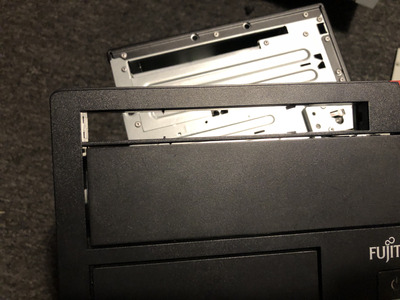

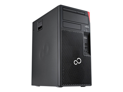

If you want to fit a slim line cd drive to a Fujitsu office pc you have to buy a specific one?
So nice of Fujitsu to make standard parts not fit.
There is totally enough space... They just decided to make a metal part 2mm higher and add 4 plastic posts that make it impossible to fit cheap drives.
1.96 MiB
1029 views
1.42 MiB
1029 views
It is designed to take regular drives... and they decided... NO... Make that not work.
Really consumer friendly.
OF COURSE a fitting one is 10 times more expensive than a generic one...

Shame on me... It is a "ultra slim drive" instead of a "slim drive" ... it seems that it is a newer standard... i was just too incompetent to know that 3mm less height is a new standard...

Same situation with notebook optical drives, there is 2 heights. Get the thinner one, it will fit. The mounting screw holes of these optical drives are standard. Next, there are two types, one is ATA and other one is SATA with mini 5V connector.

Most sellers dont mention if a drive is slim or ultraslim.
I found a way to find out if its either one by looking at the screw holes at the back.
On a regular slim drive all 4 screw holes are the same heith and roughly centered with the sata connector.
on a ultraslim drive 1 screw hole is in the same location as on a slim drive and 3 are lower, in line with roughly the bottom of the sata connector.
