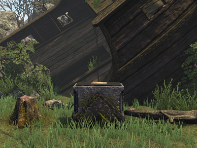

Well it's easy to test how a 3D game would look integer scaled vs an interpolated scale:
722.65 KiB
970 views
1.6 MiB
970 views
The integer scale image might be sharper but if you're close enough to see the difference, you're likely also close enough to see all the terrible aliasing.
That's a more ideal interpolated scale (lanczos) than you're getting out of current AMD/Nvidia drivers of course, but you're not getting integer scaling out of them either. Puzzling enough there's a huge movement asking for integer scaling in AMD/Nvidia drivers and basically no one asking for better interpolated scaling algorithms.
Integer scaling is as you mention better for 2D games, but there's already plenty of workarounds for integer scaling those (dgVoodoo, DxWnd, IntegerScaler).

It should not be one or the other. You can use any kind of interpolation / AA algorithms in the GPU, but still want to avoid interpolation by the LCD, by choosing a resolution that is either native or an integer quotient of the native.

It was an example image to show exactly what happens you integer scale a low resolution (and 1080p is low resolution). You see the aliasing very clearly. I can see it clearly on a 4k@27" display.
In a more extreme example, you can integer scale 240p to 1200p, but the base resolution isn't enough to get perfectly smooth edges. 1080p isn't a good enough resolution for that either. The pixel structure of a 1080p native panel just helps, letting your mind fill in the blanks, sort of like using scanlines for 240p titles.
A 1080p 3D rendered scene needs interpolation of some kind to be accurate (to the object displayed; not to the original 1080p image) on a 4K monitor. Integer scaling isn't a solution.

Having thought about it again, I think I understand you.
Even if we assume that 1080p on a 2160p display of a given size looks exactly like 1080p on a 1080p display of the same size (i.e. 100% sharp), your claim is that it still looks worse than a higher res (between 1080p and 2160p) with interpolation (whether done by GPU or LCD algorithms); and that is simply because larger pixel size = more visible edges and jaggies.
Am I getting your point correctly?
