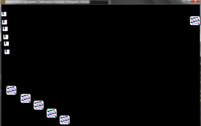

Reply 85 of 85, by dr.zeissler
I put it up here so it's perhaps better then the text in yt.
    STARS.ASM.zip
    2.58 KiB
