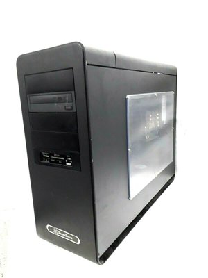

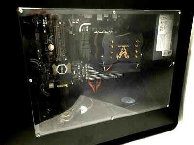

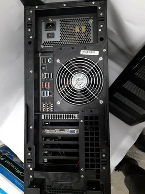

Reply 6 of 28, by BSA Starfire
Funny you should bring up early i7 machines, I bought this beauty last night, will arrive Monday/Tuesday.
Silverstone FT 02 case(really cool design).
ASUS Sabretooth x58 motherboard.
i7 950 (4 core- 8 thread 3.06 GHz).
12 GB RAM(6x 2GB).
Titan Fenrir cooler.
Xigmatek Samurai 700 w PSU.
Samsung 840 EVO SSD and 1 TB SATA HD.
And finally the less inspiring bit, a Sapphire Radeon HD5450 1 GB graphics card.
Sellers pics:
101.55 KiB
2258 views
194.67 KiB
2258 views
242.01 KiB
2258 views
