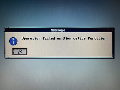

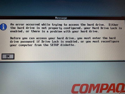

Reply 134 of 142, by stefanvl
I also have a Compaq Armada 1750 and get the 'non system disk error' constantly. I have a backup of the original disk, I have a copy of the setup diskette and the diagnostics diskette. I sometimes use the original hdd, sometime different types of ssd's or compactflash cards to run windows 95 from. It will work for a day, sometimes more, but then it will go back to 'non system disk error'. I then have to run diagnostics for a bit or take out the hdd and try, or try the ssd's or compact flash cards. I just replace them and start it up and it will work at times (sometimes it doesn't work for days). Sometimes I just do a fresh install but this is very time consuming.
Is it just time to give up on this one?

Reply 136 of 142, by stefanvl
I now get the follwoing errors while trying to create the diagnostics partition
61.39 KiB
83 views
95.07 KiB
83 views
Reply 137 of 142, by Joakim
I think this just you CMOS battery. You need to configure the HDD via the setup diskette but if you unplug it from the outlet will forget and give you this error at next bootup untill you run setup again.
