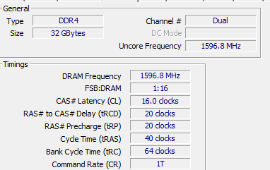

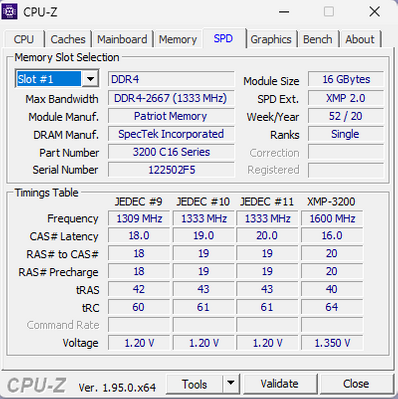

I have Pariot Viper Rams.
They sell as DDR4-3200 ..
25.04 KiB
601 views
10.49 KiB
601 views
It actually runs fine at 3200 but SPD says 2667 only..

I'm not sure about XMP, but it appears that gaming memory sticks usually use a lower SPD (JEDEC timings), and you definitely need to turn on XMP in order to use the rated speed. However, not all motherboards have XMP, though it's always possible to configure those timings defined in XMP by hand (which was what I did before I become aware of XMP).
I also had similar gaming-focused DDR3 sticks that are rated higher (like 1600 or 1866), but they only contain SPD info up to 1333 and require XMP to use the higher clock.
On the other hand, general-purpose sticks (not so optimized for gaming), and even ECC ones (more useful for AMD platforms), do have all the SPD up to the clock they were rated, though they are usually configured to use JEDEC timings by default, which are usually laxer than those defined in XMP.
