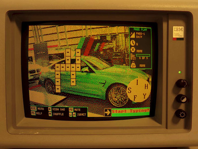

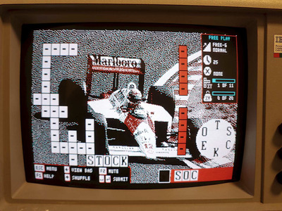

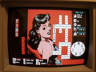

I've been working on a project called xyWords - a small cross-word anagrams game inspired by the mobile game "WordScapes"
Puzzles are on a 19x11 tile board and you use the letters in the circle to make the words and clear the level.
Puzzles can be in free-play or organised into collections.
Also included is xyPE - the puzzle editor.
Released as Public Domain.
Requirements: IBM PC (8088@4.77mhz), CGA graphics, MS-DOS 2.11+ and 384KB RAM.
If you're using DOSBOX please use the machine=cga setting and max cycles (or some high amount)
It's written in Quickbasic 4.5, probably has a lot of bugs, but hopefully works well enough to be fun 😀

Nice! Is that first screenshot in the 320x200 mode with cyan, magenta and white palette? If so it looks great considering the limitations!!

Thank you, yes - Palette 4 indeed!
To convert from original photo to dithered one I used the mighty dithertron https://8bitworkshop.com/dithertron/#sys=x86. … mage=seurat.jpg
It's an amazing utility and while not 100% accurate, it is 1bn times better than anything I would've come up with.

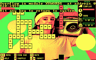

...I get this error (at the same address) whenever I start any puzzle. This is on a 640K IBM 5160 with CGA and XTIDE, running the full version off a 2GB CF card under MS-DOS 6.22.
The really curious part: this does *not* happen in 86box or PCem, which I set to emulate pretty an exact copy of the above machine - everything works just fine in those setups.

Oh wow - overflow and it looks like when the timer is about to intialise.
The timer counts up using a calculation and increments a counter.
That one I might be able to trap.
Thank you so much for giving it a try, I love how it looks on a real CGA CRT (despite the crash)
I don't have a 5160 but I have an XT luggable (8086 not 8088) and CGA and that doesn't occur.
I might need to set up another PC with an 8088 and give it a test.

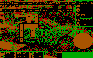

For now, I found a bit of a clue (and a workaround).
I managed to reproduce it in DOSBox-X, with 'cputype' set to 8086. This made it easier to debug:
7.39 KiB
711 views
10.88 KiB
711 views
That ":2459" return address is placed on the stack by a subroutine just before it. The problem occurs within this code, which starts at offset 264Fh in the .EXE file:
082D:244F 8BF0            mov  si,ax
082D:2451 CD35 int 35
... [stuff here gets modified by int 35] ...
082D:2459 A3F20F mov [0FF2],ax
The INT 35h handler inserts a subroutine call at :2454 and returns to it. The crash happens somewhere within that subroutine (which gave me a headache when I went tracing through it).
What's INT 35h then? DOS compilers typically use it for floating-point emulation - in plain DOSBox with x87 FPU enabled, the modified code contains actual floating-point instructions... so I'll assume that QuickBasic is trying to pull the same thing.
Luckily, in those emulators that do play nice with this code, all it ever appears to do is set the AX register to 8000h. So as a workaround, this can just be done directly. It's not a proper "fix", but it seems to work for me (so far).
To apply it in v1.0.1, hex-edit XYWORDS.EXE and change these 5 bytes:
Offset 2651h,   from:   CD 35 04 9A 28
to: B8 08 00 EB 03
My conclusion is that QuickBasic 4.5's floating-point emulation code is just buggy - not that I know much about QB, but there has to be a way to make the compiler not use it. Might involve avoiding float values in that part of the code altogether.

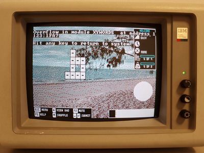

VileR wrote on 2023-04-14, 21:25:
Interesting, makes sense. I can think of these possible workarounds:
Let's try QB 4.51, VBDOS 1.0 or PDS Basisc 7.x.
Alternatively, Turbo Basic/Power Basic.
PB also has many compiler options for FPU/CPU - but also a bit of trouble with CGA, if memory serves (palettes, BLOAD etc).
Or alternatively, let's use an x87 emulator TSR so that x87 emulation in QB library isn't being used.
Requires an 80186/80188 or higher CPU (80286 up), though, I suppose. 🤷‍♂️
Edit: I've been a QB user for many years, but I've spent most of the time on vintage systems (mainly ATs, 286/386/486).
So far, I've never encountered such a problem.
When I ran QB on an XT a few years ago, QB simply used the installed 8087 silently. Otherwise, before the 8087 was installed, it worked the same.

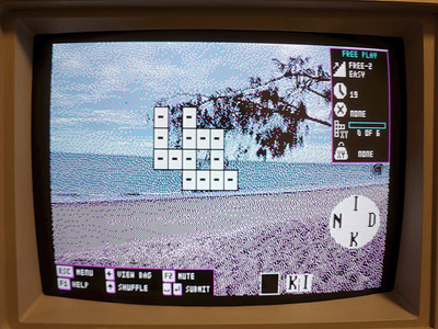

Oh yeah... since the above makeshift "patch" has allowed it to run on my XT, here are those CGA CRT photos 😀

Reply 18 of 28, by 4xtx
Wow those CRT images look great! I'm so pleased to see it working there.
So far I've only been able to test it on my mono CGA luggable and interpreted VGA -> CGA on my XT.
I had one of those style CRT's as a kid but I was lucky enough to have a EGA card which meant I could use the low-res EGA 16-colour modes too 😀
OK, on to the error - it's funny, we've approached the same conclusion from completely different angles.
Looking at the trace files (/T) I the fail is occuring exactly where I thought it would:
sTimer = TIMER
PlayTimeSec = 0
KeyTimeSec = 0
Now this looks like an innocent enough piece of code, but the error might lead me down a different path.
TIMER gets called a few times before this point:
- Before and after the loading screen starts to ensure the screen shows for atleast 3 seconds (for faster loading PCs)
- Then we have the kicker - RANDOMIZE TIMER gets called so that the puzzle keyword gets shuffled. (during 'Set up Puzzle HUD')
- I then call TIMER again to get a starting position for input. It's at this point it crashed as the very next line outputs a comment to the trace.
EDIT: Uhuh, DOSBOX-X to 8086 and Disable FPU - there we go..
I think I have a lead here, I note some lazyness in my variable management with sTimer.
It's possible I accidently had FPU enabled while compiling and didn't pick it up.
What's curious to me is: why the lack of FPU on my 8086 luggable and 8088 desktop does not cause this problem.
