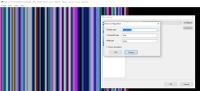

One more thing to note - the way the artefacting worked (atleast to my understanding) was to position certain color pixels next to others.
This can be generated with something like my screenshot
After I figured out the pictures might be too hard - I began thinking about colorised patterns and gradients as the backgrounds and then enhancing the UI elements to match something similar to what I'd do for EGA. The font on the other hand - really challenging given it's 5x3px and it's going to look nasty with my techniques used

Not if you use CGAArt (by one of the coders on 8088 MPH, incidentally). 😀 It can do composite as well as RGB.
Be aware that there are two revisions of the IBM CGA (early/late, AKA "old"/"new"), and the artifact colors they produce over the composite output will differ. There's one mode that will look reasonably similar in both cases, which is mode 6 (640x200) with the "BW" bit of Mode Select set to 0, and the foreground color set to 15 or 7.
On the other hand, with non-IBM cards all bets are off, even when they have color NTSC output; IBM never documented or specified what the artifact colors are supposed to look like, so not too many CGA clones really bothered to replicate the same behavior.
Either way, the best approach from experience would be to re-convert the source images specifically for composite, rather than tweak the existing dithered RGB images. It also helps if you 'pre-cook' the input somewhat to better match your target mode and palette, but that goes for any conversion in general.
