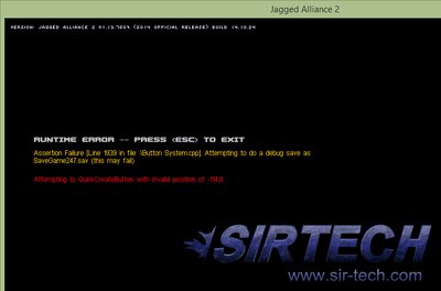

Jagged Alliance Gold with official patch 1.13 perfect, with unofficial patch I have this error
Outwars perfect in 3d and software mode

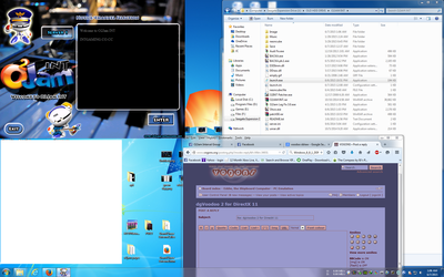

i tried dgvoodoo 2 for ddraw but when i tried to login, it goes to window mode
i think there's a conflict with the IE calls ingame *just my theory
Game: O2Jam
http://o2jam.intgamerz.net
sometimes it lags

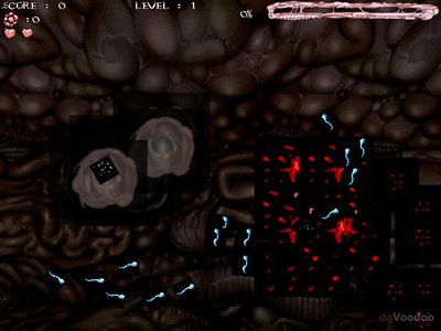

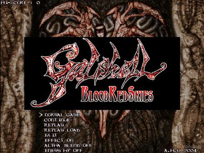

Galshell, a freeware game (so should be easy to find) has sprite transparency issues (the sprites are 24 BPP images). FYI: it's not a porn game, but it's not very safe for work...
Works natively, but too low framerate to be playable.
Hellbound by the same author also has transparency issues, but it also has crippling performance issues in dgVoodoo2 (well, the title screen runs at 6 FPS natively and 2 FPS with dgVoodoo2...).

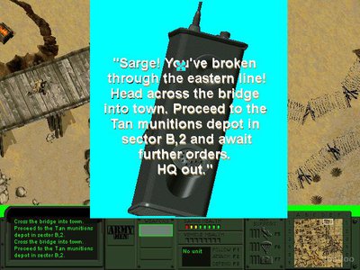

How well does Army Men 2 perform on dgvoodoo2 and a modern system?
It's perfect, but there's a problem:
1: in the system database it's set to win98 compatibility by default and this breaks dgVoodoo2, you need to disable this entry.
2: if you disable that entry you'll break FMV playback. I have just created a custom compatibility mode that's all the Win95 compatibility fixes without one that seems to frequently break wrappers (DirectPlayEnumOrder , which doesn't actually make a lot of sense).
