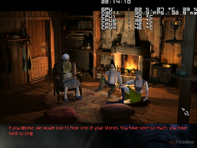

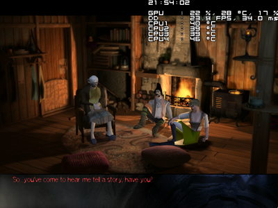

dgVoodoo2's MSAA implementation results in cursor trails in The Longest Journey. Not that it matters since dgVoodoo2 allows you to use ReShade for much more flexible post-processing antialiasing than any alternative.
Nvidia FXAA (best option available when running the game natively, so blurry):
901.98 KiB
4770 views
dgVoodoo2 + ReShade + SweetFX (seems like a perfect compromise between blurriness and jaggies with no tweaking of settings):
901.98 KiB
4770 views
No AA (very ugly imo):
901.98 KiB
4770 views
You need to view in fullscreen to truly appropriate how bad Nvidia FXAA is for this game. Oh and dgVoodoo2 does not work with the GoG build of the game. Wonder what GoG did to break it... Dialog windows are an annoyance (overwrite save, exit game), but I'm guessing that's GDI integration again.
