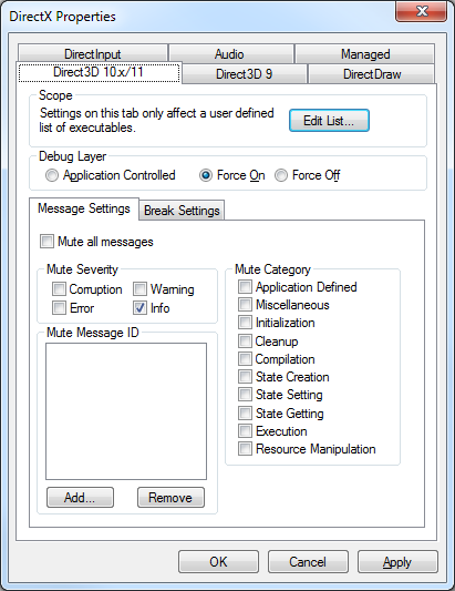

Reply 226 of 3949, by collector
That is what I had. The attached log is from what you see in the screenshot. It is probably much the same as the first one. As I said, it crashes as soon as it tries to paint the window.
    MoE.log
    2.14 KiB
    113 downloads

Reply 228 of 3949, by Dege
Hmm. What if you disable mute severity on 'Info'. It seems the debug layer doesn't get activated for some reason.

Reply 235 of 3949, by collector
Dege wrote:
So, through the DirectX control panel (32 bit) on the Direct3D10.x/11 tab you can set the debug layer usage to 'Force On' and se […]
So, through the DirectX control panel (32 bit) on the Direct3D10.x/11 tab you can set the debug layer usage to 'Force On' and select the glide wrapped exe's folder into the list of affected executables, see the attached image.
And then, launch DebugView (if you don't want to attach to the process by Visual Studio):
http://technet.microsoft.com/en-us/sysinterna … s/bb896647.aspx
It displays debug outputs coming from any application.
If all that set up, then start the glide application, get to the point where it does not work and see the output of DebugView. DX11 debug layer outputs a lot of info, warnings and errors if any detected.
I have your wrapper DLLs in the game's folder and I have that folder selected in the DirectX Control Panel. DebugView was launched and connected to my PC (obviously as it was capturing from the game), but the DebugView is only capturing the game. Your wrapper must be attempting to wrap the MASK.EXE as it is crashing the game. What am I missing?
