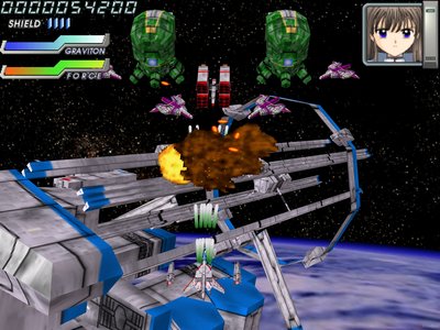

Ace Saga: The Lament of a Raven, despite its problem of being a bit too full of Korean text looks like a surprisingly decent RTS. It works flawlessly in dgVoodoo2 and even resolution forcing works (the game is usually limited to 1024x768 with bad UI scaling). Weirdly enough it needs the "Disable8And16BitModes" compatibility flag or Windows will automatically use the "DWM8And16BitMitigation" flag and you really don't want that. I say weirdly because no other games run with dgVoodoo2 manages to trigger this.

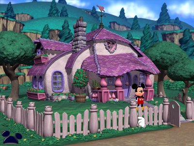

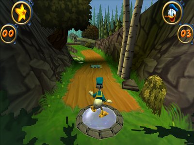

Disney's Mickey Saves the Day. Nothing to say here. Works flawlessly, resolution forcing works flawlessly (it's a 640x480 only game):
1.62 MiB

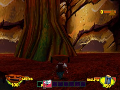

Fur Fighters works great with resolution forcing though it supports up to 1600x1200 as is. If 32-bit zbuffer is not specified in game options it will look really bad. Forcing resolution creates lines in some 2D UI elements (the kind you would expect from forcing resolution/AA, not glitches).
771.34 KiB
5931 views

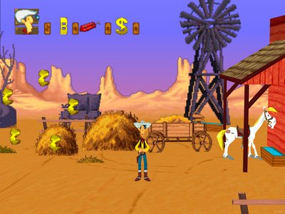

Lucky Luke: On the Dalton' Trail works perfectly with resolution forcing (640x480 only game), the Glide render works too, but pictured is the Direct3D render.
691.39 KiB
5931 views

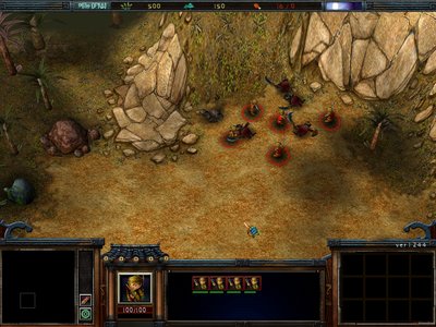

The Lord of the Sea, a Korean Warcraft 3 clone seems to work perfectly. Fonts are missing but they're missing natively too, probably due to me not having Korean fonts installed. Resolution forcing works, but you can already get 1600x1200 by editing an ini file. Still nice to be able to go higher I guess:
1.46 MiB
5929 views

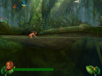

Disney's Tarzan, a Glide game, seems to work perfectly with resolution forcing:

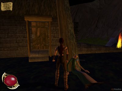

Drakan: Order of the Flame. I was going to try this again earlier but forgot it, I couldn't get the mouse cursor working, I think UCyborg mentioned that "Fast video memory access" affects this. So I tried again now and what do you know, Drakan: Order of the Flame does work perfectly. Resolution forcing also works (and is needed since bad UI scaling), but non-integer scaling, texture filtering overrides and antialiasing makes text look bad. Though for antialiasing you can obviously just downsample and/or use post-processing antialiasing. Screenshot is without AA though:
250.27 KiB
5877 views

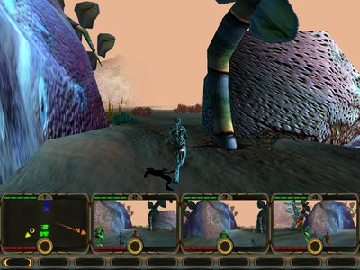

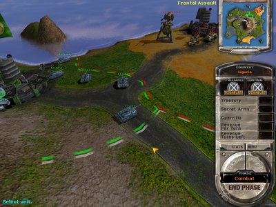

Now this is nice, Every Extend one of my favorite little timewasters runs perfectly with resolution forcing, by default it just runs at 640x480, dgVoodoo2 makes for a very noticeable improvement:
484.13 KiB
5785 views

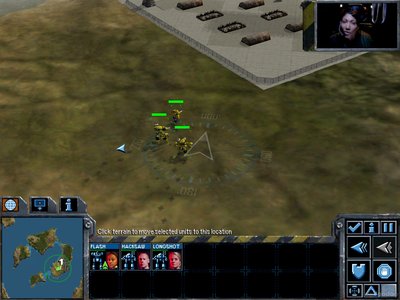

More games that just work. First Army Men RTS, by default limited to 1280x1024, which might be intentional. It reads my custom resolutions so obviously it enumerates resolutions from Windows, but stops at 1280x1024 for some reason. Well even if it had worked at higher resolution it has bad UI scaling and would need dgVoodoo2 anyway. There's some extremely minor glitches introduced by resolution forcing.
1.21 MiB

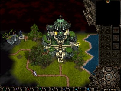

Etherlords is a game that's limited to 1024x768 with bad UI scaling. Sadly it seems to render the mouse cursor separately so with dgVoodoo2 and resolution forcing you get artifacts when moving the cursor. Still worth considering it over dealing with low resolution and bad GPU/monitor scaling though. Forcing antialiasing, texture filtering or non-integer scale resolutions is a bad idea here. Also for some reason dgVoodoo2 insists on running the opening videos windowed.
1.28 MiB
5729 views

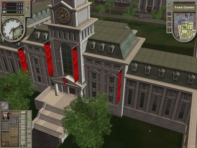

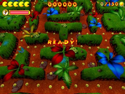

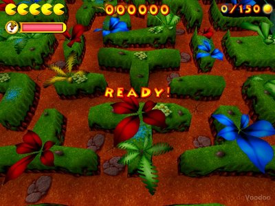

Pac-Man Adventures in Time also has issues:
111.66 KiB
5640 views
Here's how it looks natively:
117.57 KiB
5640 views
Demo here: https://archive.org/details/PacDemo

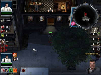

Gangland works perfectly. Has bad UI scaling so resolution forcing working is nice, but it is not flawless as it has some minor artifacting.
932.91 KiB
5611 views

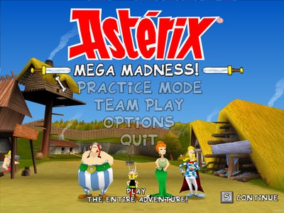

Asterix Mega Madness works flawlessly. Resolution forcing works, but breaks fullscreen (nothing you can't fix with Borderless Gaming). The game does natively enumerate all resolutions, but higher resolutions (haven't checked how high) breaks graphics.

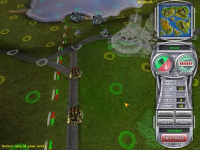

Massive Assault works great as long as you select software mouse (hardware mouse is invisible). Resolution forcing works too (helps with UI scaling). Antialiasing and texture filtering is another matter, so in this screenshot I've used ReShade's SMAA shader:
1.37 MiB
5480 views

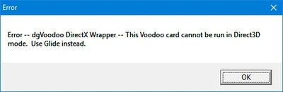

The Summoner is being oddly specific about calling dgVoodoo2 a Voodoo card and refusing to initialize the D3D render. Maybe the D3D render just looks to see if the card is called *Voodoo* and errors out if it does?
12.87 KiB
5428 views
Well if that's the case, maybe just hex edit the exe and rename any references to "Voodoo"?. Works pretty great:

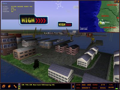

Dangerous Waters seems to work fine, though there's a separate topic about it. By default limited to 1600x1200 with sort of bad UI scaling so dgVoodoo2 might be beneficial.
1.05 MiB
4999 views
