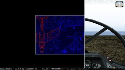

Reply 3365 of 3949, by mnii
Hi, I'm first visit here.😀 First of all thank you for the great works for old d3d and glide games.
The reason I'd written here is I'd like to know how to work well Mig Alley by Rowan sofware company. I tried it with dgvoodoo2 when dgvoodoo2 came to support dx7 games. However the game screen is not that good for playing due to the below game screen I attached. The version of Mig Alley is 1.23 or BDG patch 0.85f or 0.85f2, it seems to happen regardless of any version, and occured in all both modes which are d3d and software mode.
The loading screen(big black rectangle on the below pic) is supposed to be disappeared when getting into 3d world, but still there and blocks the playing screen. I guess it is well known issue before.
I'm using win8.1 laptop(intel hd5500 & nvidia840m optimus).
I just hope this issue could be fixed. Thank you. 😀

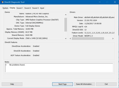

Reply 3374 of 3949, by galneon
Dege,
I was just posting some wrapper information as an alternative in this thread requesting integer scaling for Nvidia GPU drivers and had to complicate my guide for dgVoodoo 2 a bit by detailing the binary vs text dgVoodoo.conf overwrite problem when using a game-local dgVoodoo.conf binary saved via the Control Panel. I know you're probably aware of this issue (some of us discussed it here shortly after the advent of the text dgVoodoo.conf), but I just wanted to remind you of the conflict just in case.
Edit: It looks like me and another user overlooked something when troubleshooting the conf overwrite issue here a few months ago. I thought the text-based .conf deferred to the binary .conf for unspecified values, but the text-based .conf actually goes with default values when not specified (as specified in the readme). I think some confusion could be avoided by renaming the binary version that the CPL saves to dgvoodoo.bin to avoid the risk of overwrites (or renaming the text version to dgvoodoo.ini which would probably be easier), and having the text version defer to it is for unspecified values. Then we could have game-specific bare bones (only the options needed) text-based INIs for advanced options which complement one's regular global CPL settings.

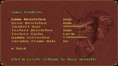

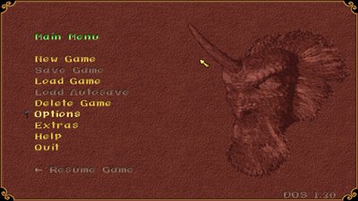

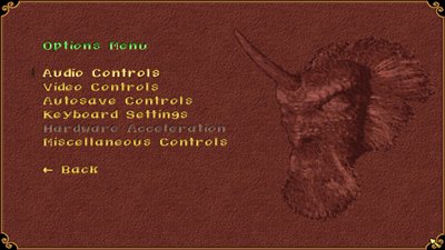

willow wrote:
I have 3d acceleration with glide and whith direct3d (bilinear filtering is ony available with 3d acceleration). Graphics are similar and it's normal because with the last patch of LoL, it's the standard comportment.
I'm not sure if you understand, quite yet, so I've included some screen shots. Main Menu shows you it is DOS 1.30--GOG version. Options Menu shows you what it looks like when GLIDE acceleration is not available--note that "Hardware acceleration" is grayed out. BiLinear filtering only shows up when Hardware acceleration is turned ON--in the absence of GLIDE acceleration, BiLinear is not available in my version of the game. THe "Video Controls" menu shows the full gamut of D3d options available--D3d software options, note. When Glide acceleration is enabled then all of these options are grayed out with the exception of bi-linear filtering which is then visible and selectable. Last is my D3d diag page to show you that D3d is enabled on my system. As I mentioned I also have D3d hardware accelerated games from that time which run accelerated fine.
Now, *if you and I have the same version* of the game then you are running the Glide emulation when the option for bilinear filtering shows up shows up. If we are not running the same version--somehow--then I'd like to know where to get a patch more recent than the 1.30 DOS version of the game....😉
Again, I'm of the opinion that this is caused by something Microsoft has done in these latest builds that is somehow interfering with both DG Voodoo2 and nGlide--because both wrappers functioned fine in earlier Win10x64 builds. If you'll read some of the earlier posts in the thread--this is what they are talking about. I was only hoping that someone could offer some advice. I can play the game all day long in D3d software mode--it just doesn't look near as nice as played hardware accelerated through the GLIDE wrapper.
