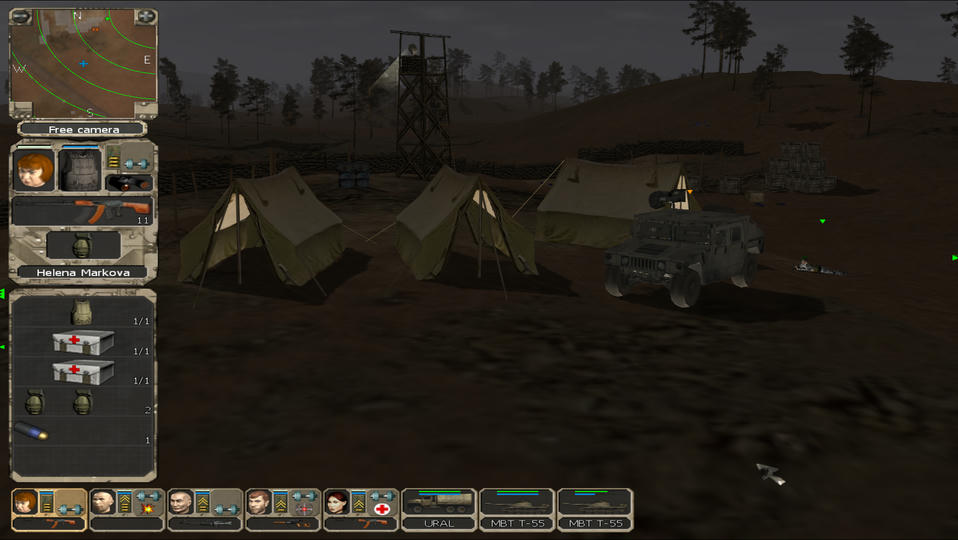

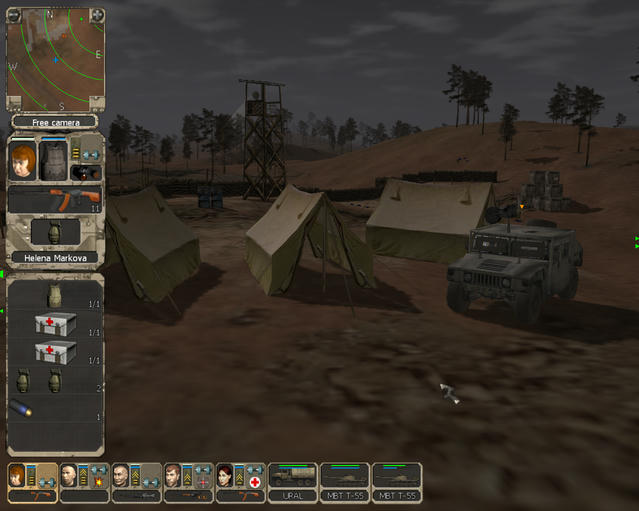

Postby V15UAL K3YS » 2018-4-04 @ 00:19
VirtuaIceMan wrote:What version of Road Wars do you have? I got a US re-release, but the chrome effect on the cars goes transparent up close. The version is 1.0. There is a demo of version 1.1 with fixed chrome effect, but I have to run it with the chrome disabled.
Version 1.1 (though this version comes with a different chrome map texture than the demo version online). I don't have the chrome effect issue you're having in my version; the game runs fine with it and I don't have any transparency issues with it. Regardless of how the graphics settings are adjusted though, the graphical glitching I am getting doesn't go away. I am using an NVIDIA GTX 1070 GPU if that helps.
Here's another screenshot (running with dgvoodoo2): Image
V15UAL K3YS

Postby Dege » 2018-4-16 @ 19:04
V15UAL K3YS wrote:Hey! I wanted to thank you Dege for making dgvoodoo2 in the first place; I can run Test Drive 6 and Final Drive Nitro with it perfectly; able to override the in-game resolution and achieve much high graphical quality and framerates.
I wanted to report a graphical error it has with one game. I am trying it in one game in question known as Road Wars, a 2001 PC Combat Racing Sim that uses Direct X 7.0. In Windows 10, the gameplay runs fine but the loading menus and such are incredibly slow and choppy, and dgvoodoo fixes this. However, in races, the game shows strange graphical artifacts in the form of white/black dotted lines when using dgvoodoo2. The game uses DirectX 7.0 and requires d3drm.dll to run.
Works perfectly for me on AMD and Intel. On nVidia I get the same flashing dotted appearance as you.
I know where the error occurs during rendering but don't know why. I debugged the wrong pixels by the graphics debugger but even debugging the pixel shader yielded what was expected.
Seems to be an nVidia-flaw. :confused:

Postby szabozadam » 2018-4-27 @ 12:21
Hi Dege
I ran into a problem with soldiers of anarchy (I saw that you fixed a crash with it not that long ago so I'm hoping you still have the game around :) )
For context: the game uses Direct3D7, on maps (out of menus) it tries to set a directional light (at 0x00613A4F in version 1.1.2.178) with the parameters:
Code: Select all
  d3dLight.dltType = 3;
  d3dLight.dcvDiffuse.r = v6[15];
  d3dLight.dcvDiffuse.g = v6[16];
  d3dLight.dcvDiffuse.b = v6[17];
  d3dLight.dcvDiffuse.a = 0.0;
  d3dLight.dcvSpecular.r = 0.0;
  d3dLight.dcvSpecular.g = 0.0;
  d3dLight.dcvSpecular.b = 0.0;
  d3dLight.dcvSpecular.a = 0.0;
  d3dLight.dcvAmbient.r = 0.0;
  d3dLight.dcvAmbient.g = 0.0;
  d3dLight.dcvAmbient.b = 0.0;
  d3dLight.dcvAmbient.a = 0.0;
  d3dLight.dvPosition.x = 0.0;
  d3dLight.dvPosition.y = 0.0;
  d3dLight.dvPosition.z = 0.0;
  d3dLight.dvDirection.x = v6[22];
  d3dLight.dvDirection.y = v6[23];
  d3dLight.dvDirection.z = v6[24];
  d3dLight.dvRange = 0.0;
  d3dLight.dvFalloff = 1.0;
  d3dLight.dvAttenuation0 = 0.0;
  d3dLight.dvAttenuation1 = 0.0;
  d3dLight.dvAttenuation2 = 0.0;
  d3dLight.dvTheta = 0.0;
  d3dLight.dvPhi = 0.0;
This looks as such with native DDraw
But with dgVoodoo2 (either the WIP44 or the 55 version regardless of settings):
I tried playing around with the parameters of the light set just above the call (again with game version 1.1.2.178) (though I must declare I'm not experienced with Direct3D7)
I could get the desired effect with native DDraw (red light for example) but dgVoodoo seemed to disregard any change I made to this call (even changing the light type) always stayed like on the picture.
I tried all the settings I could think of in the cpl and otherwise but if I'm not the first and someone found a fix to a similar problem I would be quite curious about it.
(As an endnote I admire the work you did bringing back the games of our childhood I hope you'll keep at it :) )
szabozadam
Posts: 5
Joined: 2017-8-04 @ 03:04
