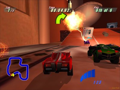

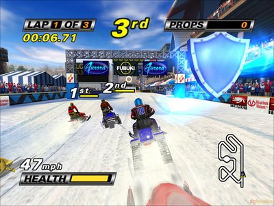

Some more uninteresting (as in they all work perfectly) games tested:
Mangchi The Hammer Boy doesn't like dgVooodoo 2.55.1+, otherwise no problems. Minor graphic glitches with resolution forcing.

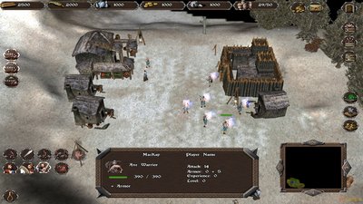

Room Zoom: Race for Impact doesn't like dgVoodoo 2.55.1+ either, but no other problems.
309.99 KiB
3517 views

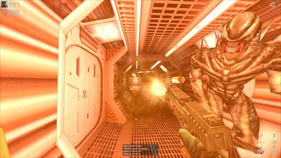

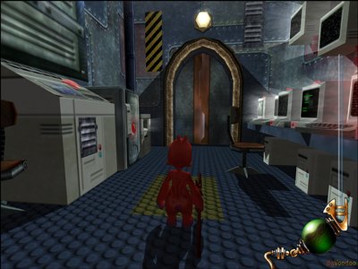

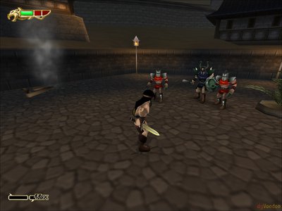

Kaan: Barbarian's Blade also seems to have a problem with dgVoodoo 2.55.1+, but otherwise has no problems.
278.49 KiB
3517 views

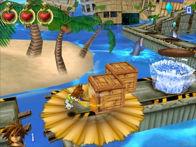

Gift seems to share enough similarities with Kaan that I think it runs on the same engine, however it works fine in dgVoodoo2 2.55.1+ and shows black screen instead of FMVs when resolution forcing is on.
382.43 KiB
3517 views

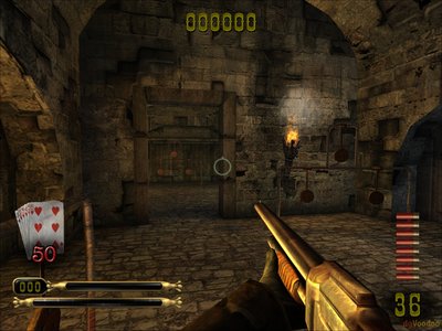

Dead Man's Hand is an Unreal Engine game with no issues. Needs a framerate limiter though.
492.9 KiB
3515 views

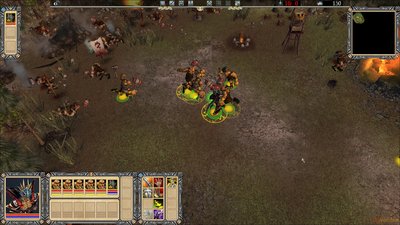

Highland Warriors (demo) has double cursor issue when resolution forcing, though the game has perfect high resolution support and no need for it anyway.
1.05 MiB
3515 views

Those games are all fixed in 2.55.3.

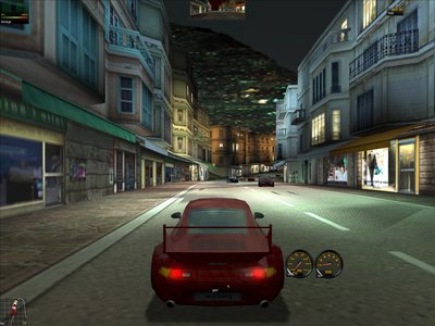

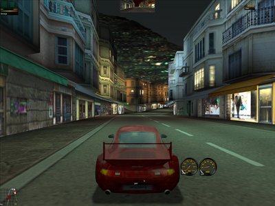

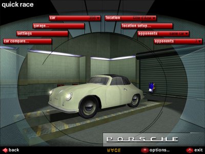

Need for Speed™ Porsche® 2000
Main menu with bumped up resolution w/o issues with latest dg 2.55.3; full 32 bit color, instead of 16 bit default.
197.15 KiB
3178 views
Unfortunately, there is a problem with lighting heavy flickering (screenshot is not showing this of course, but flickering is very intense); not spotted by me before, due to playing only day levels. 😀
231.96 KiB
3178 views
If lights go off - no issues.
216.81 KiB
3178 views
Attached log from DebugView.
nfs5.log.zip
108.08 KiB
160 downloads
