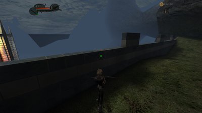

Reply 3740 of 3949, by KainXVIII
Minor flickering in foggy distance in Enclave on 8 level, also some minor texture flickering on models, not very serious 😊
PS - forcemin24bit does not help

Tested it and it no-longer freezes! perfect.... but then found another issue that I'm hoping you could test.
I was just playing the level "Driller Night!" upon discovering a new cavern after drilling northward the game camera seems to fly go way out of bounds and the map goes black. Everything else works though.
This is what happens after opening a new cavern: http://prntscr.com/kuaq7y
Thanks mate!
