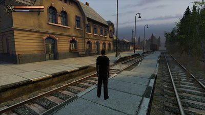

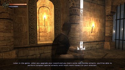

Shade: Wrath of Angels benefits a lot from resolution forcing for two reasons. First the health/mana bar doesn't scale to higher resolutions, second when screen effects are used the game renders internally at a lower resolution. dgVoodoo fixes both of these issues and I can't see any obvious problems:
There is however one problem, that happens regardless of if resolution is forced or not, if you zoom into the sword this happens:
Natively this isn't a problem. Good luck if you want to fix it as you first get the sword at the end of a really long tutorial you can't save in.

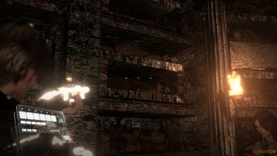

Tested some Resident Evil games:
4 seems to be perfect as far as I can tell, not tested it much though.
5 gives an error and crashes on boot.
6 has problems with lighting/bloom on some objects, especially around the edges.

wrote:Shade: Wrath of Angels benefits a lot from resolution forcing for two reasons. First the health/mana bar doesn't scale to higher […]
Nice catch, thx for that! Fortunately I managed to struggle through the tutorial and fix it. 😀
