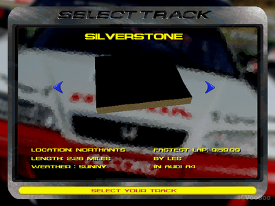

TOCA Touring Car Championship 1.1
Track previews are black.
Also blank intros (yep, Indeo again).

Reply 154 of 1111, by Firtasik
Dege wrote:
They are black natively too, and also, checking it out on a video, still black:
https://www.youtube.com/watch?v=WniAcmf2TPE
Indeed. 🙁
It looks a bit better here:
http://www.mobygames.com/game/windows/toca-ch … meShotId,11900/
PS1 version is fine:
https://youtu.be/PxTJD4aJLpY?t=3m15s

Reply 156 of 1111, by VirtuaIceMan
ToCA maps are dark then lighter when unlocked. Back in the day on my old PowerVR/3Dfx cards they were much, much lighter, but now show black.
Menus are in software mode though, not D3D (I believe). Something in the lighting went wrong somewhere along the line.
My PC spec: Win10 64bit, i7-4970K (not overclocked), KFA2 GeForce RTX 2070 SUPER, Creative Soundblaster ZXr, 16GB RAM, Asus Z97-A motherboard, NZXT 410 case, ROG Swift GSYNC monitor
Reply 157 of 1111, by Dege
Maybe a bug in Win98 D3D implementation which was fixed in the NT D3D line but it broke TOCA?
It's indeed a lighting bug, the game places 2 point-lights that provides light for the maps, but the top of them are out of scope, lights seem to be placed badly.
